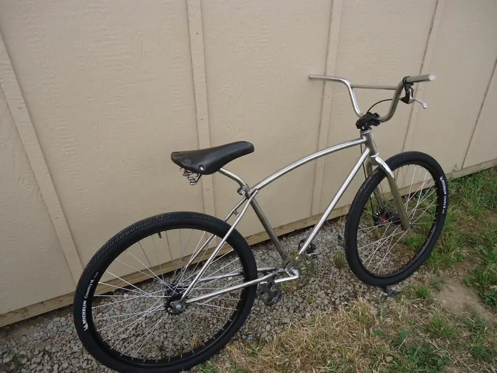

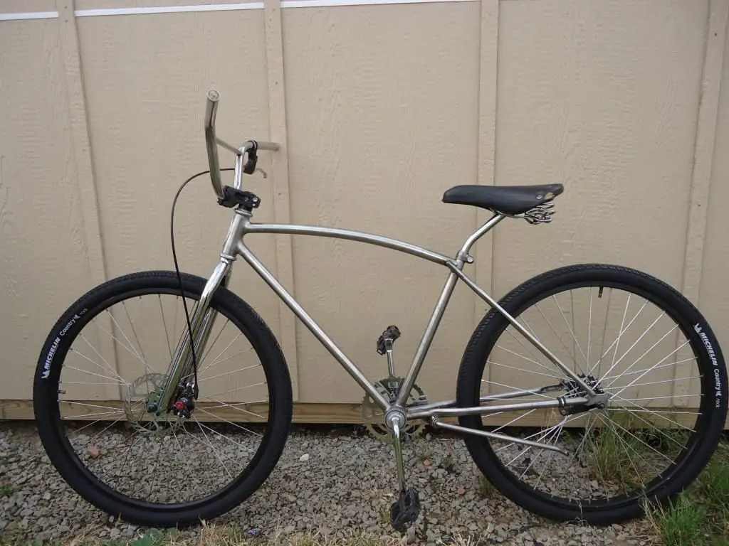

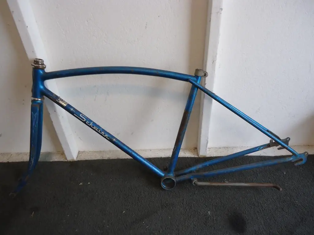

Here we go with a new project for the summer. I recently came across a 1967 Schwinn Racer (aka speedster/ camel-back) frame that I got off ebay for cheap. It got Saturday and here is what it looks like... I plan to build a BMX racer out of it and put a motor on it of course (^). The frame out of the box looked way too small for my size. I thought I made a bad decision at first. I did a quick build with spare parts and it looks better with wheels, forks and a seat. About the same height as my BTR. Project still on!
takes 26" wheels and has a 19" frame

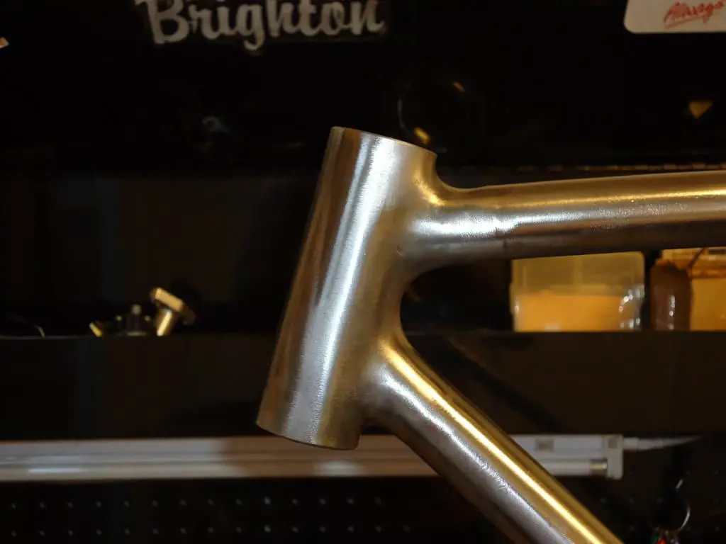

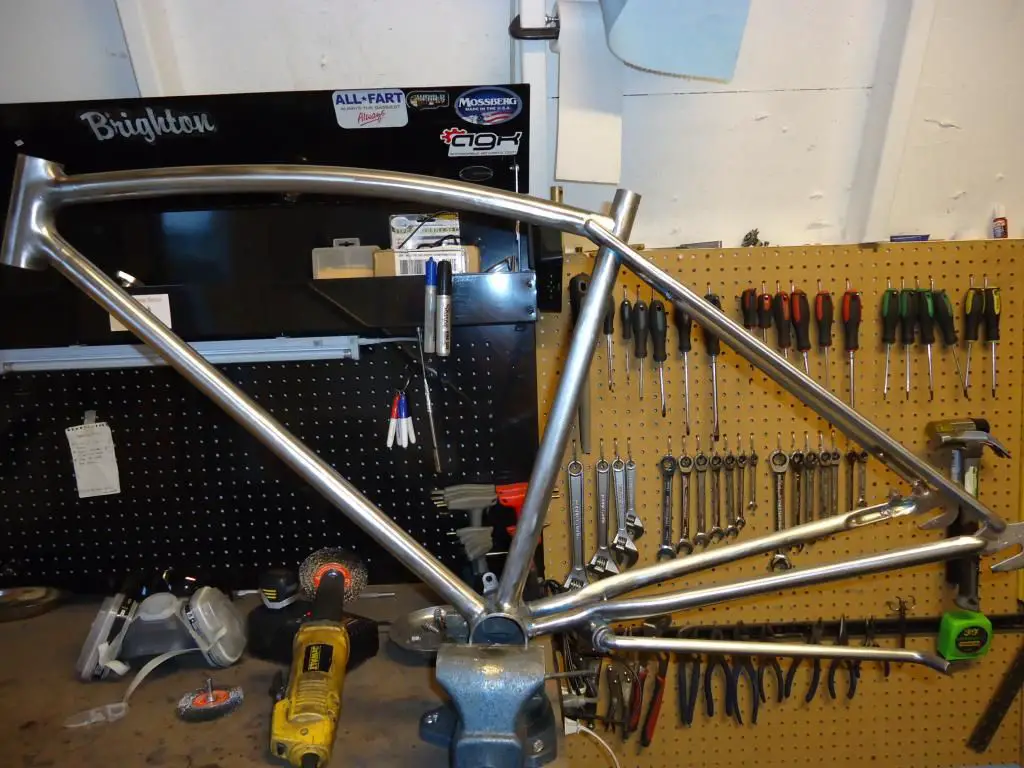

I took a day off from work today. Not really. I took it off to work on the bike :p. The way I received the bike, well, it was a mess and needed to be stripped asap. No chemicals here, just the right tool. The frame cleaned up very nice. I'm thinking about leaving it raw now...
i built a 24" speedster for my last race bike. i also have a 26 that's still a bicycle. i love those frames.
one problem you're gonna run into is tire and chain clearance. those bikes are designed for 1 1/38 rims and you'll need to stretch the rear triangle to squeeze fatter tires in there.
there's a how-to on here somewheres, or you can google "sheldon brown frame stretching."
other than that, it's a simple build. plenty of room for a motor with those frames. bolts right in...
good luck. :)

Your right Baird, they are really nice frames! Your build was part of the inspiration. I like the strength and simplicity of these frames. I did a quick mock build with some spare parts and I was able to get a 26x2.125 in there, that I stole temporarily off the wife's cranbrook. There was maybe a 1/16" of clearance on each side of the tire both top and bottom of the triangle with the tire 90% inflated. I think I should be able to run 1.75 maybe 1.95 and be okay. I need to beef up the welds in few places and then I can paint it or leave it raw, I still cant decide. Thanks for the kind words! :)
More to come...

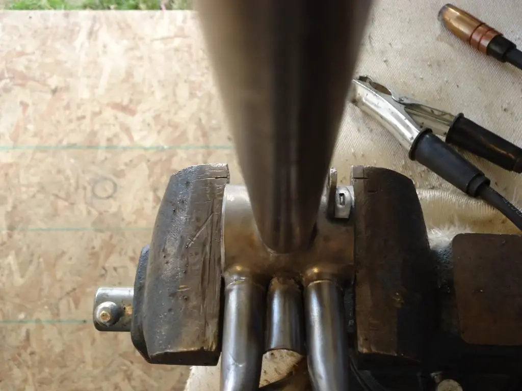

if you can weld, beef up the top tube/seat tube junction and the bottom bracket to rear chain stays junction. those are the weak points.
Those old "electroweld" frames have such a cool look around the headtubes. Gets that fillet brazed shape on the cheap. Looking forward to seeing your progress.
So shoot me! I took another day off from work to make it a 4 day weekend for fathers day :). Plus work on the bike :p

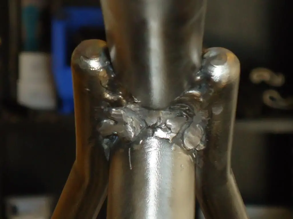

Morning project complete. Per Baird's advise I welded up the seat junction, underneath so it looks untouched from the top. I also beefed up the rear triangle with a round gusset that I made from a handle bar cut in 1/2. I still might add a flat plate on top of the round one for added strength (kinda like a double wall rim).

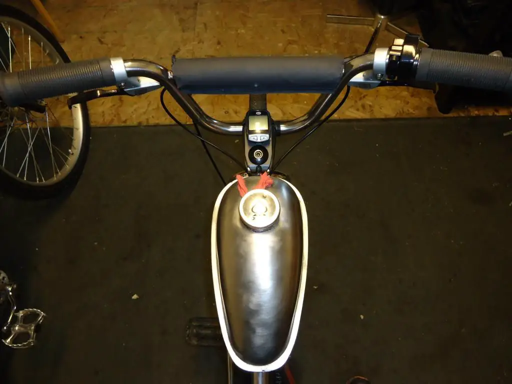

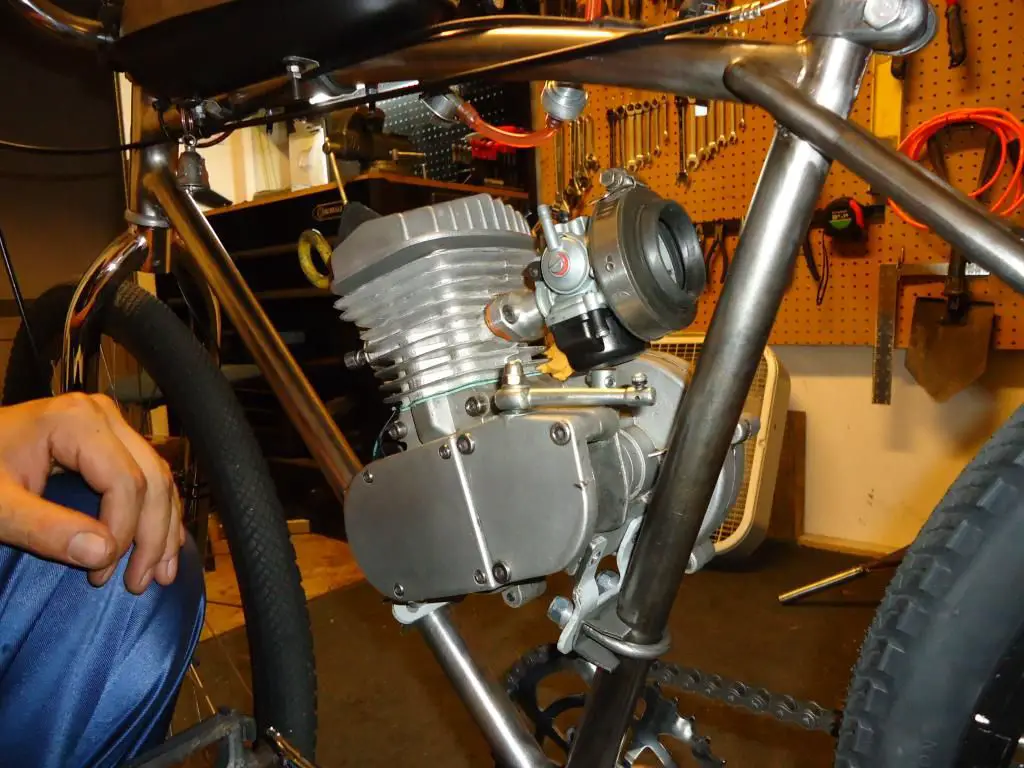

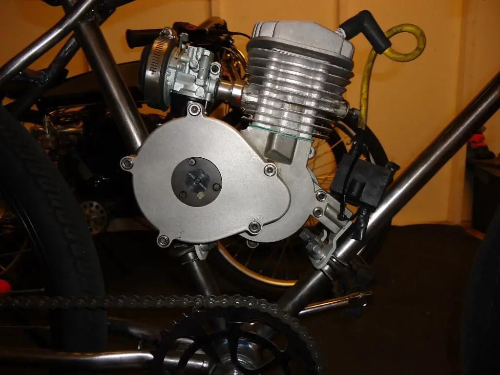

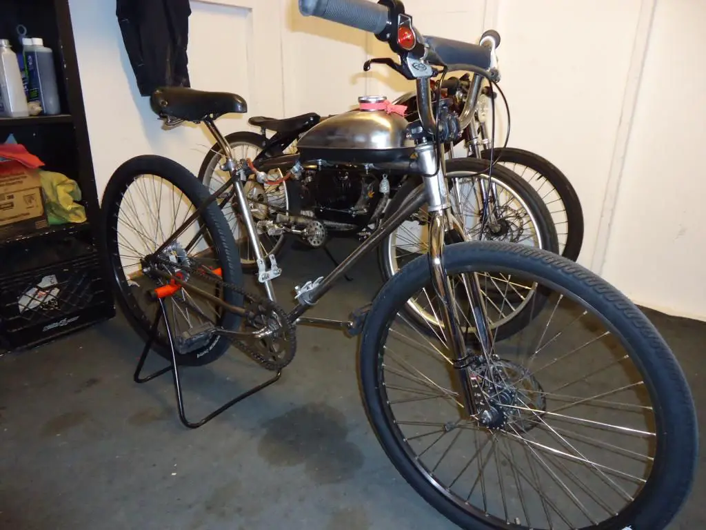

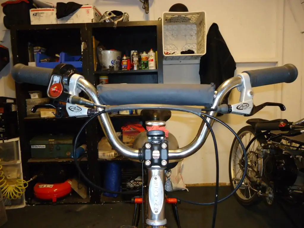

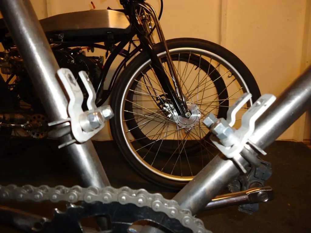

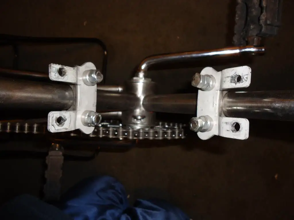

Okay, so the bike is all wired up. I ran the cables and fuel line, and cut them to length. I also installed the peanut tank temporarily till I can find a different tank that I like for the bike. That being said, I wire wheeled the top of the tank to match the rest of the bike. I left the bottom of the tank black to look like a top tube pad like on the older bmx's. Rather then using the stock mounts that are with the motor I used SBP mounts for the front and rear. They say that it isn't designed for the rear but it works very well. I just needed to shave 1/8 off the chain side of the rear mount. Extremely soild!!! Just an old Dax engine floating on the mounts, but at least you can see how it sits. I think this bike is going to get my old grubee engine and a new reed setup. Should be a screamer!
To be honest, I don't know how long the rigid forks will last on this bike. Rigid forks work on my other bike but this is a totally different build. Only time and miles will tell. Looks good in the mean time. :D

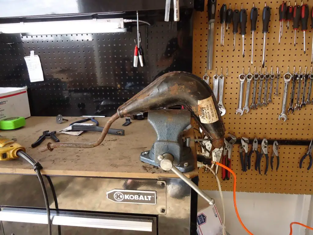

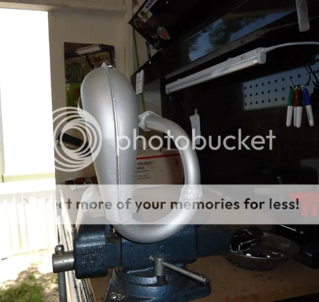

"Morini era" KTM expansion chamber to use...
Wire wheeled, welded to the stock pipe, and painted with some bbq grill high-temp paint.
