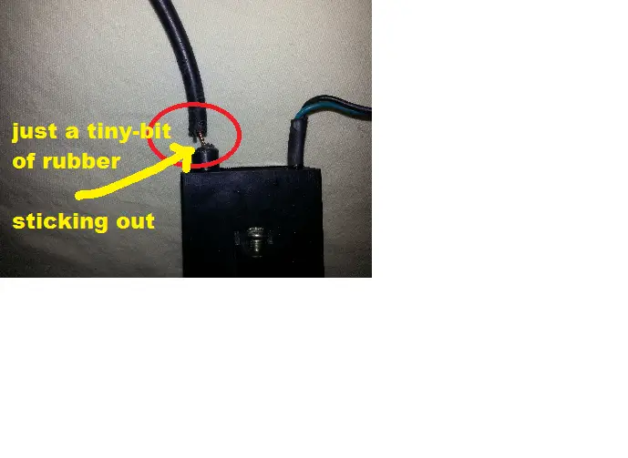

Hey guys, so I read up on this and heard all I have to do is unscrew the wire from the CDI. I grabbed some tiny wires and kind of tried it, but before I knew it all the rubber had gone away...
How should I go about this...?
(do I have a different CDI and it comes out another way?)
Thanks a bunch ;)

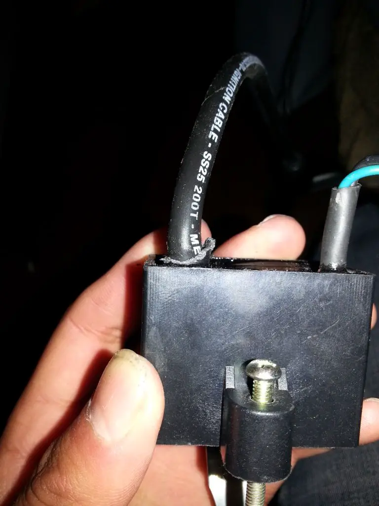

Well I got in on, as messy as it was...
So after I cleared up all the rubber (I had to get rid of the hollow cylinder too...) I was supposed to just put the tip of that metal screw into where the wire was on the plug and just tighten it in?
I did just that and I tried riding... it wouldn't start (same problem that made me think I had to replace the spark plug)

Oh, and a piece of heat shrink tubing will help at the CDI where you broke off the plastic that surrounds the wire. Did that new wire have a metallic core (conductor) or something that looked like black thread?
Got spark? LOL
Both of mine are already mounted and can't remember what the inside looked like. But the web site says they have an EMI designed alloy core with a heavy duty silicone boot.
They do work great, but I've also not had any trouble with my first bike which I installed an automotive wire and boot from an auto parts store - which did not have a metallic core.. I bought that before reading the advice on this forum...
