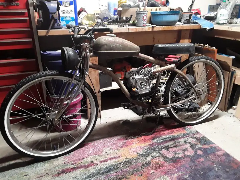

well i rebuilt my biek the way I should have done it the first time. The stuff for my headlight is coming in this week. but here it is.

Looks very good. How about some close ups of your engine mounts? They look interesting and very solid. Good work. Thanks for sharing.

Great build. Looks very very well done. But, you will never be done. You're going to flip those handlebars over a few times, maybe get some apehangers. Might get a banana seat, might paint something here, change something there.
The good thing about this hobby, is it's NEVER done. And you can tinker here and there, on the cheap. You don't have to spend 400$$$ on a single part, like I have to do on my motorcycle or Vespa.
Again, great looking build. Have fun with it and be safe!!!

I don't know if it was your intention but it kinda resembles a speed way bike, Very cool!

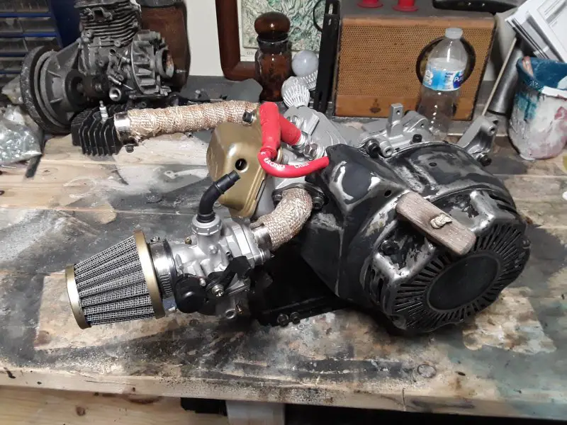

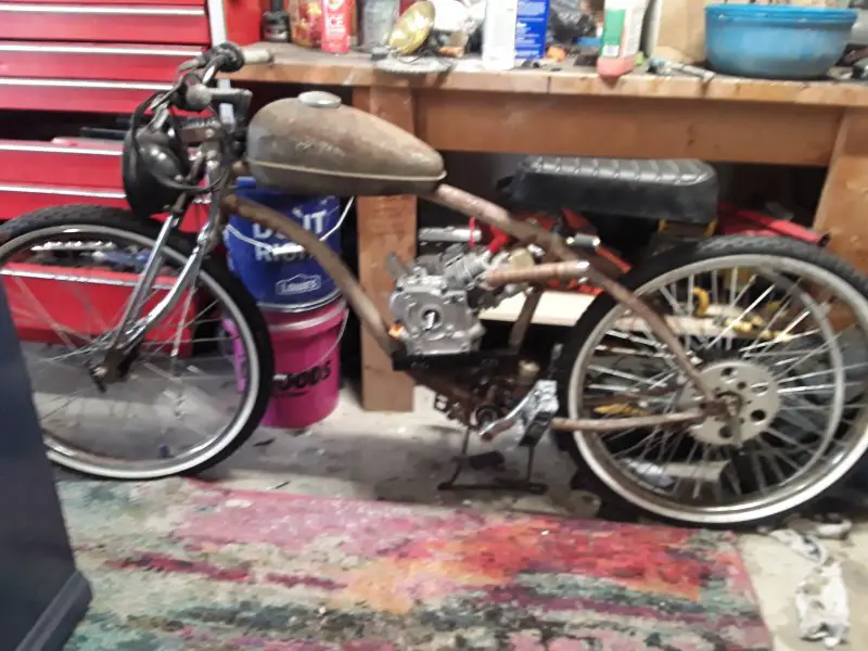

Well Its been a long time, but I finally pulled this thing out of storage and decided to give it a rebuild. Its not quite done yet, the mockup stage is about done. Im starting to actually put it together for the hopefullly final time lol
I went with a 79cc predator, it has been touched a little nothing to crazy but it has a billet flywheel, governer removed, 19mm carb, intake manifold and header. Milled and ported head with 18lb valve springs. I decided to use Grubees belt drive setup for it. seems like a nice piece of kit.

Third rebuild. Somehow they are never finished. There is always something that could be just a little better than it is.
Steve.
Mostly power, I had a 49cc 4 stroke clone on it and it was ok just not enough power. only cruise at about 28-30. I wanted to be able to go faster. its been several years since this has run. but I think now its going to be everything I actually wanted. Parts are trickling in, just gotta get everything together and perfected.
