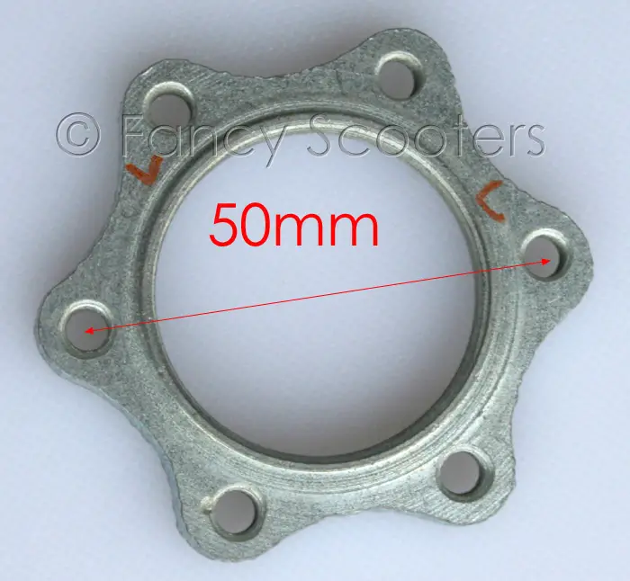

I just got around to taking the fender and wheel off,,,
my wheel has an adapter to convert a freewheel thread to a disc mount
my problem is, the rotor bolt pattern is not for a standard bicycle rotor
I do have a 180mm rotor that has the same pattern (came with a huge hub for a go-kart)
it is a lot thicker (approx 2X), so I don't think I can use it with the caliper I have
does anyone have any suggestions or places I can get rotors that fit the adapters ?
I am seeing why it only cost me 20$ for wheel rotor and caliper though ;)
Bill,
I am assuming you've got a left hand threaded disc rotor adapter for a scooter that in not ISO standard. TP_PeaceSports has rotors that I assume are not ISO standard. They have a Brake Disc Rotor D 180mm Mini Gas/Pocket Bike for $29.99 that is 2mm thick. You'd have to contact them to see if the rotor and adapter match.
