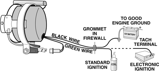

Where did you get that tach at by the way?
Did some searching, they seem to be pretty standard. ignition(12v), ground, and signal(to coil). Your orange/black is probably for a back light.
More info over here
Hmm, looked up the ebay ad, here's his text:
For All Motorcycle
Easy to install & long lasting
0-13,000RPM Measurement
Diameter : 67mm
Height : 70mm
Black line lock positive electrode --
Green line lock negative electrode--
Red line contacts signal--
Some models need to attach high voltage signal line
Net Weight: 235g
He's saying the red is for signal and black/green for battery.
Don't know if the pics will help or hinder, most use the 3 wire setup, for reference I'll leave them in.
Let us know how it works out :) Its a nice tach, good find.
