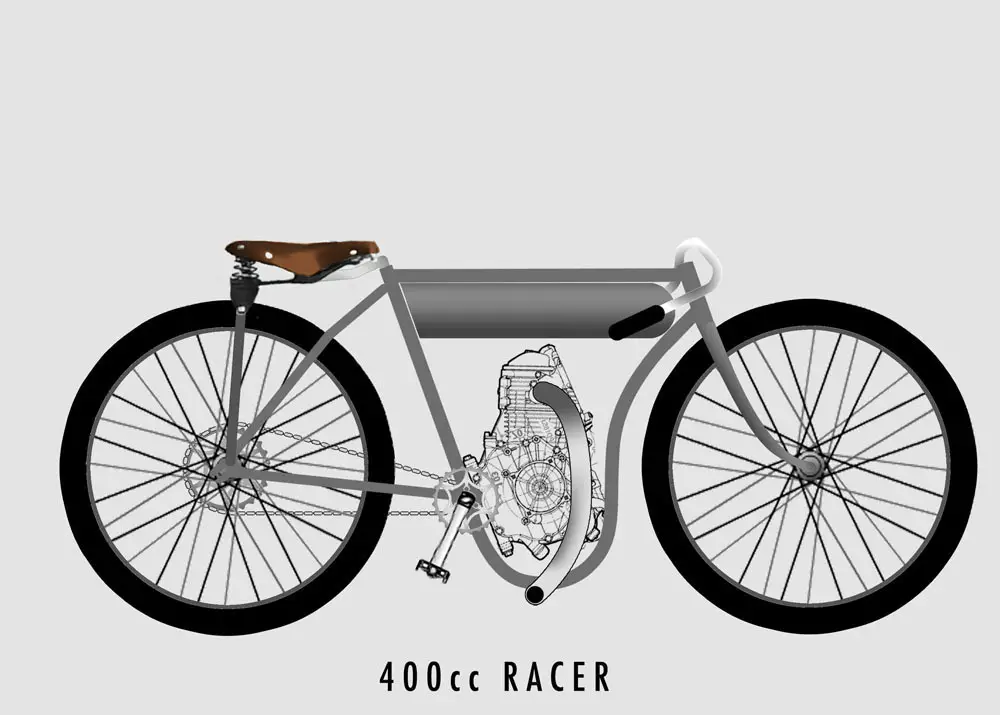

I just can't leave this board track stuff well enough alone. I enjoy it so much that I want others to enjoy it as much as I do, so I have come up with a plan to make that happen. I am currently in the planing stages of two prototype bikes, a 400cc racer and a 200cc lightweight cruiser. These bikes are inspired by a 1909 Merkel and Triumph. Both bikes will feature a pedal to start mechanism that I have been pondering for almost a year. The will also feature GX series engine that will be interchangeable with each other, or swapped out for a completely different stationary engine altogether as long as it will fit in the frame. Basically a universal engine mount.
I would like to have a similar operation to Pat (Sportsman Flyer) but on a much smaller scale, maybe only do a few bikes per year. I am hoping to be able to build one of these from start to finish in less than 3 months. I will be using a Worksman bike just like Pat does but it will be totally different. I'm not trying to take his business. Most of what I will be doing will be sold locally. However I may sell the pedal to start mechanism as kit or something.
Here are the rough concepts for these bikes I'm sure things will change when I start the builds. I would love some feedback regarding the design or concept.
The 400cc racer is you all the way, not taking anything any from your fantastic abilities as a fabricator and or builder but I think it would be a good thing to talk to Dan at Taylar Motor Bikes for the frame then do all the neccessary mods to it that you'll need, why fuss with the technicals ? and just get down to the build might just be cheaper in the long run too but no matter what you decide it will be KILLER!!!
Would fabrication/building be helped by using two engine plates around the bottom of the engine instead of a tubular steel cradle?
Will you be using a single speed, a CVT or even a slushbox torque converter?
Other thing I noticed after a quick look at a pic of the engine, the filler drain plug will be under the engine when mounted. Where will you fill it from, and will you have a level screw or sight glass or dipstick to check the level?

That's one job you don't have to do. While I think, what sort of brakes will go on it? Personally, I'd love to see big, single sided, single leading shoe drums, but that's probably too expensive and fiddly to do.
I would like to see band brakes. Authentic to the period, and pretty simple to fabricate or modify OTC kart parts

If you could make the frame where a 50cc, 200cc or 400cc could be installed in it you would have better ability to sell them. You could offer them in either a race style or a cruising style bike.
I also think you would do well to make them as a kit (rolling frame), they provide the power plant or different stages of a complete ready to run bike. Just some of my thoughts on it.
