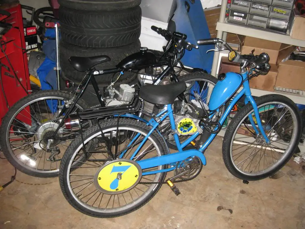

been slaving away. The Blue Baron is a time consumer. The bike of choice is alot sturdier than most "walmart bikes". Murray made in USA. She is as old as me and im fine with that.
Waiting on new rims and MSD sparkplug. zpt

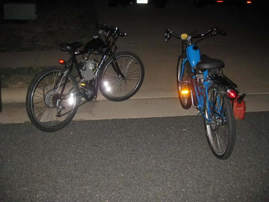

UPDATE! Drove her 50 miles today in in rain through dusty trails to highway roads. Ran GREAT!
Prior to this run I bent the frame by going off another jump. All fixed and a sprocket hub adapter was installed. Updates soon.

I went to V.A. last September to help a buddy of mine (moongoose is his forum name) Being that I've started a very small business building these, I figured what the ****. I love a good trail rump and a cruise down the old road, and a buddy to join with is the more the merrier. Here's some pics:
All I have to say, is after all the break downs, after all the bs these things present, in the end of the day, they are worth it.

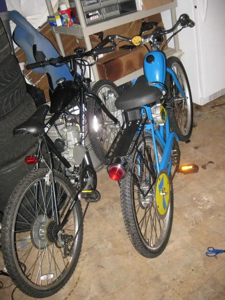

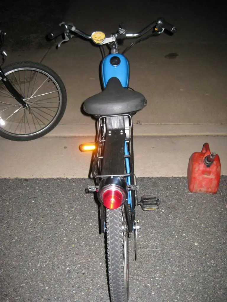

Since than i've installed a 12v front led lighting system(inside classy vintage housing) that runs off the engine (via magneto). It works amazing, and I have a vintage rear running light that runs off 2 massive D cell batteries that power a tiny 1.2 volt led E bulb. Basically the batteries will last as long as the bike.
In addition to a 36 tooth sprocket and HUB adapter for NJ cruisin'/easy trail ridin'. It did more than enough in the hilly area of V.A. to prove itself to me.
