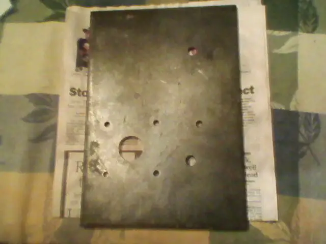

Since I'm swapping out motor and drive system on my 5hp robin build, I figured I'd make a new thread. Currently I have just about everything for the new drive sysem made. It will be similar to the old drive system but this time it will have an additional jackshaft.

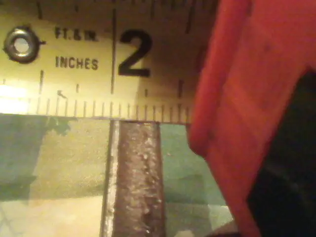

Got a question some of ya might be able to help me with. I plan on bolting a plate to the side of the motor using the 4 holes around the output shaft. Plate will be holding a spring loaded tensioner and an idler. I originally planned to use 1/4" thick by roughly 9" by 8". I picked up some that is 11/32" (a tish under 3/8") because it was cheaper. I'm starting to wonder though, is 11/32" going to be too heavy for the motor to hold? More pics coming
Update-Found a jackshaft plate made by gtc that apears to be roughly the same thickness, still wondering though. http://gtcmanufacturing.com/images/view.aspx?productId=44&index=1

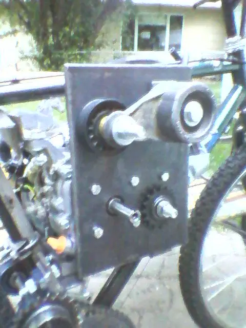

My jackshaft is held be two pillow block bearings mounted on the rear motor mount of the bike. The plate is there just to hold the idler and tensioner so I can get the rotation of the engine reversed. I should have a fair bit done be this evening, I'l try to get more pics then.

Not completely done with the plate. Have to recess two of the holes and trim it down a bit.

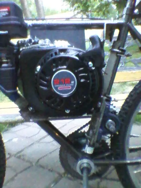

I love the "Out of the box" design otherwise. That motor looks so much better with a forward slant and
I am sure it will it will run cooler with better airflow. Thanks for sharing.

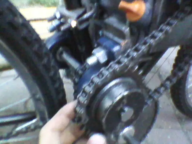

Ya the chain routing will be similar to the robin build, only changes being the idler and the output being a jackshaft instead of the bike's crank. Pic of the routing on the Robin.

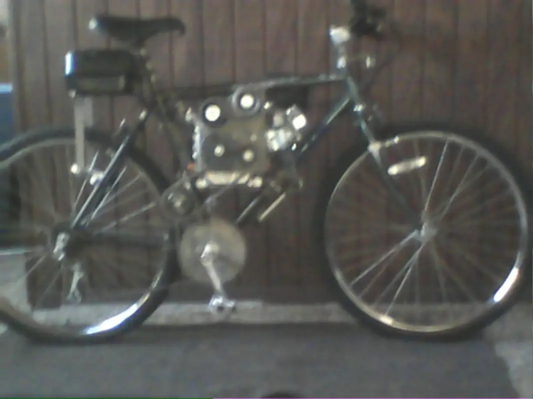

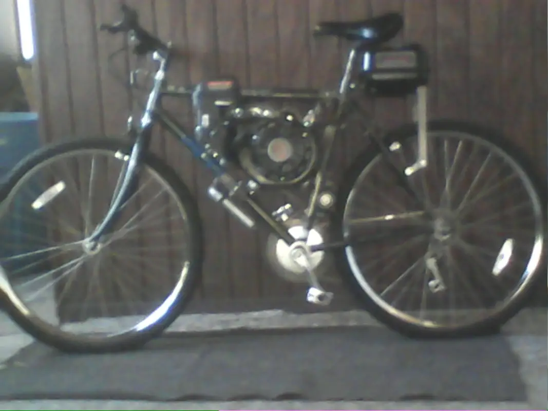

Hope I didn't wait too long to post an update, this thread is getting kinda far down the list :)

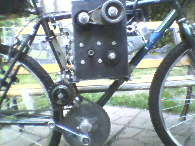

Got it done and riding. I don't think I lost too much by going with the idler sprocket set up. When the motor is at idle the rear wheel will start turning when lifted off the ground.
Only complaints I have- It's kinda hard to stay on when I punch the gas, might need a better seat(I wonder why :) ) and the plastic car belt tensioner makes a bit of noise, witch I think might diminish when the plastic ribs are removed. If not, it might be worth it to swap it out for an actual idler sprocket like the one mounted directly onto the metal plate.

Very unique thinking. I like it. Although, I'm still thinking about just a two gear way to turn the rotation around to put the motor in the correct way. Head forward is the correct way for a non vertical single cylinder engine like the predator. Just my preference really.
