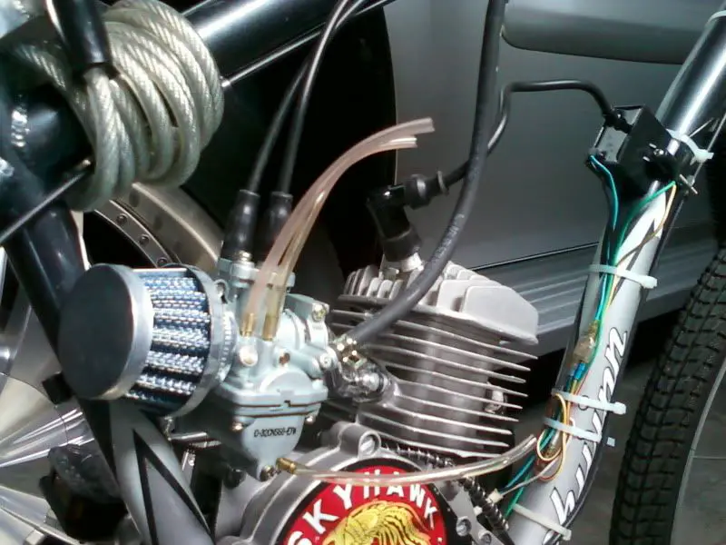

I have a CNS V2 carb, slightly modified at this point, haven't had one of the V3 in my hands yet.... That said, the three tubes you were asking about, the bottom one is the overflow, keep that tube pointing downward where it can drain away excess fuel if there is overflow. The other two just need to be open (connected to nothing). On my V2 carb one of them go into the air filter, I originally had the red plastic air filter, while your V3 should have a high flow cone style filter. Also, I hear the air mix screw is capped off on V3, and may be screwed in fully under the cap (a turn or two out would normally be a better position). Someone had reported that the cap comes off easy enough by drilling a hole in the cap and prying it off, then you can get at the air mix screw.
I don't want to go into giving tuning advice before you post feedback on how she runs right out of the box, so post back on how it went and we will try to help you get her tuned up...
