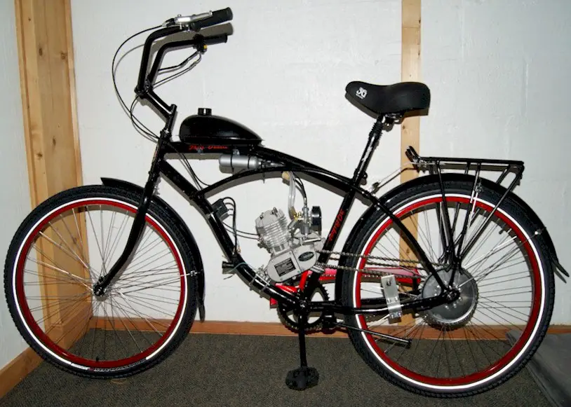

Alrighty here is my first ever build! Thanks Gearnut for the sideline help :) 48 cc grubee.
I plan on flushing out the head prior to fireing her up. So the muffler and spark plug is not on yet. Plus I am getting a new plug and dont have that yet - tomorrow. The bike is a 3G Isla Vista. So only thing left to do is flush motor, add new plug, add muffler and secure to frame and firer the ***** up!
The build went smooth and I think it looks real clean. I am a tad worried about the sprocket mount. I used both rubber mounts but left the dust cap under sprocket that is on rear hub. When I tightened everything I may have scrunched that cover a tad and I can feel a bit of resistence. I figure fugit see what happens maybe it will wear in good. The sprocket fit perfect on the hub without the outer rubber mount but I didnt feel I had enough clearance for chain. Next build, same bike, got it and motor already, I will machine off excess on dust cover for a perfect fit.

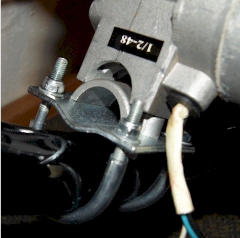

I improvised on the down tube mount inverting the bracket and using a universal mounting kit. Seems tight and solid..we'll see...Oh yea thats the booster bottles you see :\ I have talked ot the guy who makes them and feel confident the system will make it idle smoother and run a tad cleaner and thats all I expect. It may take a bit of tweaking we'll see...Bu tthey look so dam cool :)
Any last minute advice is very welcome! It is raining here on the Oregon Coast for the next few days so any last minute tweaks a possibility if ya got any suggestions let em rip mons!

I figured at least someone would diss me on the front motor mount....

i'm speechless...just joking. nice ride fugit hope you enjoy it as much as i enjoy mine.
two thumps up on your first build (^)

Looks like you did a pretty nice job on your motorized bicycle!
Have fun!
...I really feel a motorized bicycle needs to have at least rim brakes. 2 of 'em! Perilous to rely upon a lonely coaster brake! Be cautious.
The boost bottles value is controversial.
<I> feel they might have value in smoothing out the pulse at very low rpm and would like to see some sort of engineering proof of that. never ran one, myself.

I suspect it would be a good idea to keep an eye on tightening all those nuts and bolts holding your mount in place.
oh and yea thanks on this too. I used gap filling nail hardener on every bolt I tightened as per other recommendations in other threads. I am waiting on the engine mounts from bikeberry I think Manic Mechanic makes. They look great and tidy! It is forecast to rain here another week so I am in no hurry to fire her up and got nothing but time.
