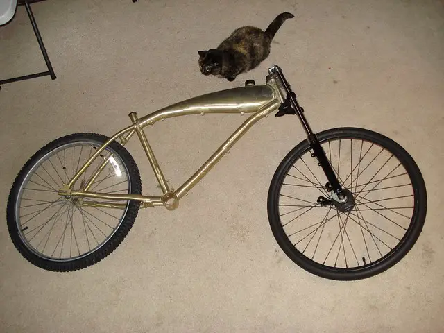

So, I am going to build a motorized bike using one of the skyhawk frames, with the built-in gastank. I'm pretty excited, because I think it will look pretty nice. I've already ordered a frame and 66cc motor, and picked up a newer whizzer fork off of the ebay.
These first parts came in this week, so I did a mockup:
The wheels are NOT what I'll use - they were just stuff I already had laying around the house, so I used them in the picture.

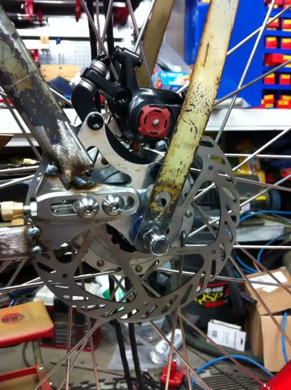

I've been looking into what it will take to mount disc brakes on this bike over the last day or so. I think the front will be pretty straight forward: grind off the whizzer bracket, and fab/weld my own to match IS specs. The rear has me worried though...
I'm thinking I'll either make some kind of slotted mount to weld onto the frame (not my bike - found this example through google image):
Or I'll make some kind of slider (also a borrowed image):
Any thoughts? I think for now, I'll focus on the wheels. Then, maybe I'll have a better idea what I'm looking at in terms of spacing, and if I'll have room for something crazy like the sliders.

Yo Sixties! mine came on tuesday night, and it looks like the build race is on! you and me buddy. I'm so excited I could S***! so, in trying to help I can offer this: I have 160mm BB7's on 3 bikes and I love them. they are lightweight and functional with no hydro fluid to bug you; no bleeding, weight, etc... although I did have a guy at a bike shop keep asking me when I was going to get some real brakes....and they do heat up in santa monica every-block-a-stop sign ****, but they work, and without much complaining. that being said, I am going to ante up to the 230mm rear disc for this bike and shine the whole drum thing. one hardly even uses the rear brakes on a bike anyway. ever check out a GSXR? double fronts and a puny rear disc. so I'm choosing to keep the weight down and do no rear drum. I like the 2nd pic you posted. that mount looks like a tad overkill but on the right track for sure. i'm curious where ya found it!

where'd you find that 2nd image sliding caliper mount?! love it.wee.

Sorry I didn't catch your reply sooner! I don't remember the website where I borrowed the image, but that style dropout is called a 'slider.' Run a google image search for 'sliding dropouts', and you'll find a TON of examples. The only problem I see with them is the hassle. Most of the dropouts I've found are blanks ready for frame-builders.

Just a quick update - I've finally got my wheels built up, and the bike is starting to come together. I still need to figure out how to mount the front wheel (The hub has 110mm OLD, and the fork dropouts are spaced at 140mm), which I think will involve welding on some custom dropouts on the fork.
Anyway, I mocked things up last night, and took a picture:
