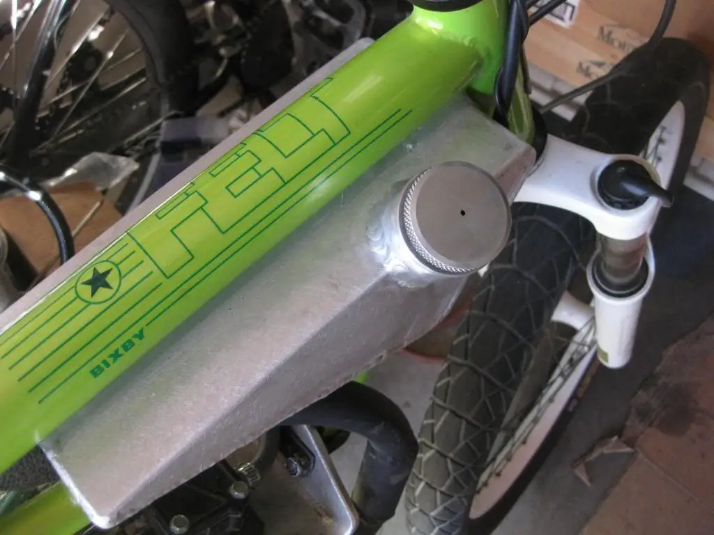

Sadly, a common problem. Some folks will drill a tiny pinhole through the top of the cap to let it vent. That can lead to fuel spitting out of it and a couple of extra holes need to be drilled into the bottom of the cap to reduce this effect. The extra holes in the bottom allow any fuel or condensate collected inside the hollow cavity of the cap to drain out.
Don't top off the tank completely if you do this though. You need air space between the fuel and bottom of the cap.

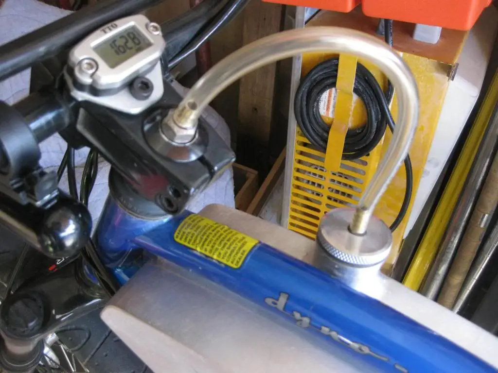

I vent my caps in one of two ways. One is to install a barbed hose fitting into a gas cap and use a length of tubing with or without a check valve as shown.

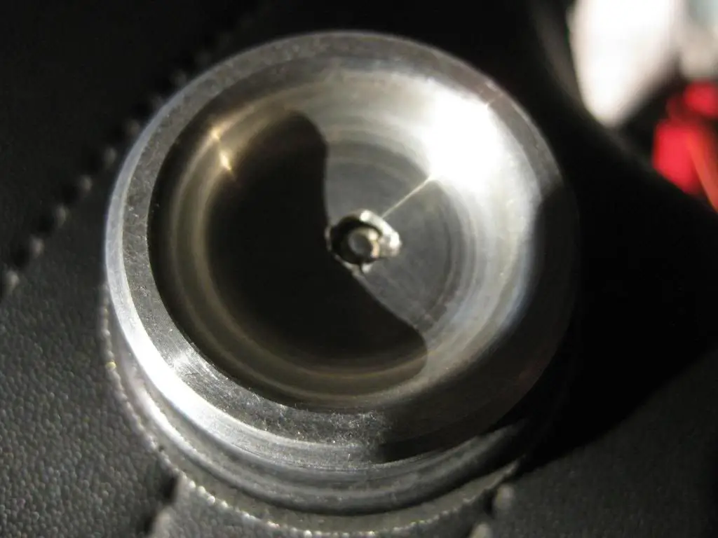

The other is to drill a 1/16" hole through the cap, then drill a larger hole 1/2 way through the underside in the same hole. Install a small ball bearing in the larger hole and peen the cap so the bearing won't fall out.
