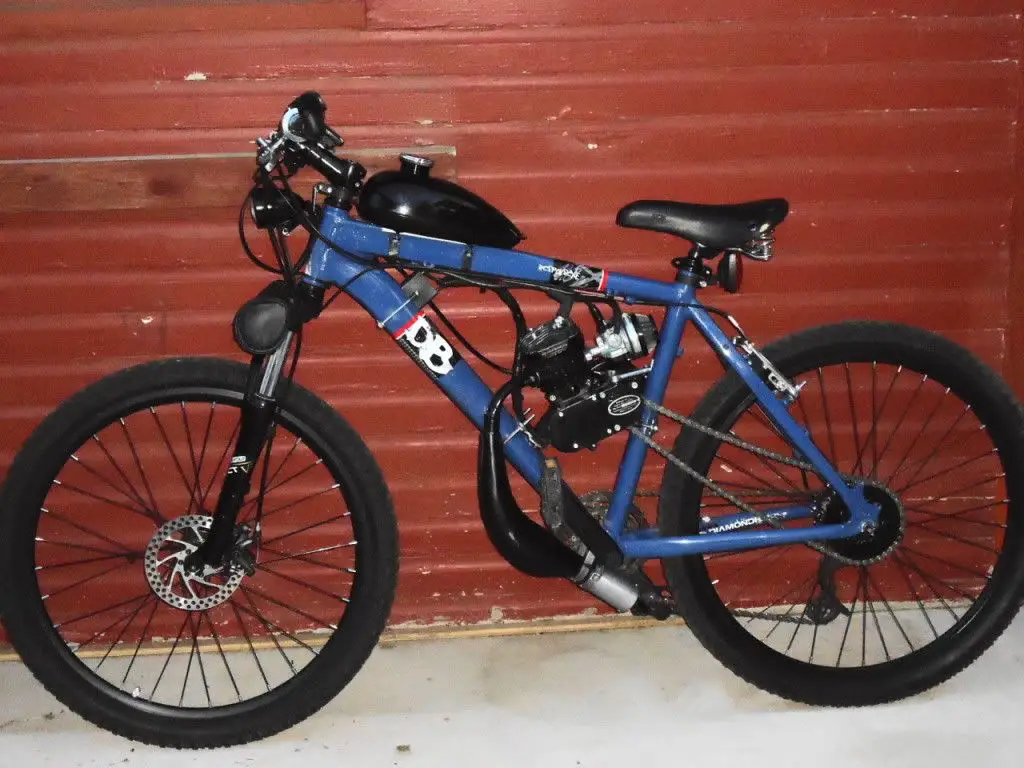

Grubee 66 Diamondback Response Sport
Lots of upgrades, this baby rides! SBP Shift kit in the works so I can put my rear disc brake back on.
Wow! Nice looking bike!dance1
My bike is a Diamondback Response too, but with 203 mm front/rear disc brakes.. I mounted a four-liter HT fuel tank on the top tube.
Nice build. I always thought it was impossible to squeeze a china motor in the newer style mountain bike frame. Guess I was wrong. What did you use to mount the gas tank on that thick frame?
Thanks guys. I used a piece of double sided tape to hold the tank centered. I used some of the chain guard that came with the motor kit to make custom mounts
yo...looks sick except i just noticed the tip of the muffler.....we should put a elbow on it and point it away from the tire......from the pics it looks like 2 things happening really fast....your gonna nuke your brake pads and spray the crap out of your tire.......like a copper elbow or something slot and clamp it on maybe.. other then that it looks awesome...cant wait to see it in person....2 stroke exhaust+bicycle tire+ dramatically faster wear and could technically affect traction especially in wet conditions....

From the picture you can't tell. But I already thought of that, the elbow is on and painted. Giving the exhaust just the right angle. The rear V brakes are temporary, I'll be getting a shift kit towards the end of the month
It wasn't running right with the pipe in the down position; the motor was wanting to run leaner, even with a leaner jet it wasn't right. It ran good only to 28mph and then blap, blap, blap.
So I mounted it back the way I had it on the cruiser, and put back in the .75 jet and it runs strong again.

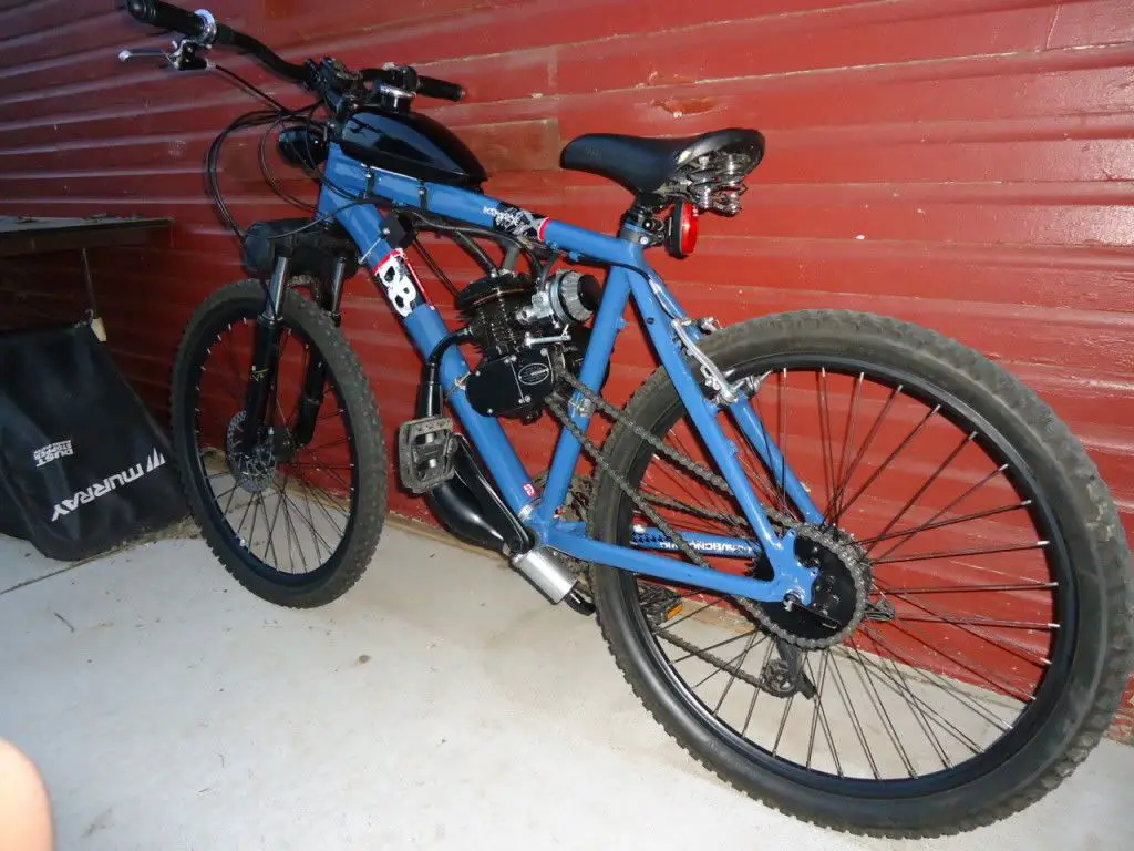

I have done a little bit more to the bike, so I figured I'd update this thread.
- advanced the timing just a bit
- added MX style fenders
- new Electra cruiser tires (very smooth)
- new Nite Rider tail-light (much better than Bell p.o.s.)
I wanted to install a shift kit, but after measuring, I don't think that it will work on my particular frame. A couple more things to do, I'll keep you guys updated.

The build is pretty straight forward. The only areas of concern are:
- the frame is bigger then most so you'll need a 2'' exhaust clamp and mounting plate for the front, and for the rear mount just grind it out till it fits flush.
- the top tube is a strong box design, this makes mounting the tank tricky. I just used double sided tape and made my own mount brackets. You can't even tell
- If you have a rear disc brake, you'll need to remove the setup and run a v brake or get a jack-shaft kit. I figured out how to run dual disc brakes but I won't disclose any info till I'm finished.
