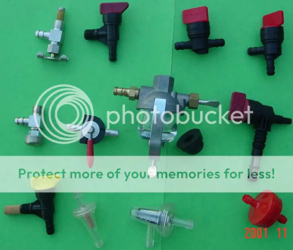

Do you mean the sediment bowl type with the shut off valve? These can be purchased at tractor supply stores, lawnmower shops and Napa Auto Parts stores.

Thanks for the info & photo. I saw your great picture when I was searching for fuel filters & still haven't found the brass one I asked about. I saw a photo of the Dorman at RockAuto but that's not it. That glass sediment bowl in your photo is the way I want to go but I can't find it at Napa & the closest part # there is SME 702350
Do you know a source where I get yours at?
Thanks - Doc
The last one I bought was at a lawnmower shop. It was a Briggs and Stratton part #690612. Once in a while I score an original Tillotson on ebay, but some are not in the best condition. The older ones have a round wire bail holding the glass bowl, where the newer ones are steel strap. Can't beat a brand new one. Good luck.
Fish that Black Rhino one is the one I saw but couldn't find. Barely, the NAPA one you posted is perfect for my use & I'll buy & BTW you've done some beautiful builds. Msr it was your photo that originally got me thinking about alternative fuel filters. Thanks guys!
I think I would like to buy one of these for my build, but I have a question. Where is the filter element? Is it just a glass bowl that allows particulates in the bowl to settle to the bottom? When people use this filter, do you need to put an actual filter element downstream of this glass bowl before the carburetor?

There's a brass screen held in place by the glass bowl, along with the gasket. This is a very effective way to keep debris from your carb.
Thanks Blues88s ;)
msrfan is defo right, it's turned out to be a very effective filter w/little to no restriction - even when mungy. The local fuel station has a serious problem with contaminants, after a few months I showed the manager the inside of my (then new) tank which was now lined with lots of soft black flecks. Those combined w/the goo & trace amounts of water trapped in the filter bowl & the fact that's the only station I get fuel from caused us to theorize they're likely suffering hose/pump deterioration, probably from the ethanol content.
A regular in-line filter would work just as well ofc, but it'd need to be replaced relatively frequently & wouldn't stop the water. The glass bowl type is ofc cleanable - but it is heavy and somewhat large. I originally got it simply to "match" the vintage bike, but have learned to appreciate it for far more than that lol, like the built in fuel shut off.
