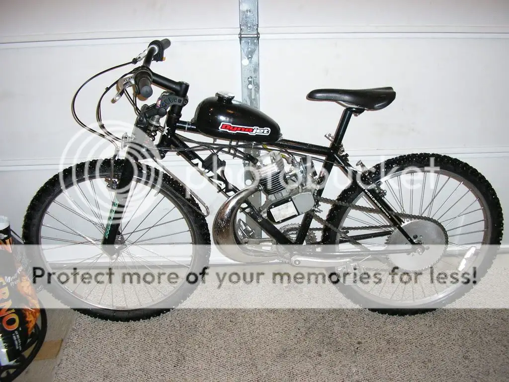

I robbed it out of a junk Huskvarna chain saw mod. #359. It's the same one thats in my Stihl saw mod. #MS361. It's a ten dollar part at your local saw dealer. I also changed out the connecting-rod bearing with a German made one(INA bearing part # K10X14X13-TV) It's much better quality with 11 rollers in cage vs. only 9 in factory one. tossed the original in the crapper. also used only one base gasket under jug-that's all that was there when new. this motor has 9:1 compression right out of the box,why reduce it. sorry u had to wait for reply. m much better with wrenches than computer.
hey, what's happening.I am assuming (hoping) that was the way China Gas shipped it out.The pits really stand out in the picture with carbon in them. There is less than fifty miles on the motor. That's how it looked when I took it off to install the compression relief valve. When my buddy (engine Andy) was milling out the cooling fins and seat for the valve install,there was poracity in the alum. up there too.I don't think it's gonna get any worse. It should be fine. At least the gasket surface was ok. I just hope they start making top end parts available soon for these rats. I'd like to have a spare piston,jug,and head on the shelf anyway just in case. I took her out today for a quick spin just to make sure everything went back together ok.(man,it's coooold out) She's runnin' strong and sweet. thanks for checking out the pics..shft.
Not sure. this is my first build so I don't have anything to compare it to.It's got some good zip to it right out of the box.I havn't done any real mods to it yet except for gutting the catalyst out of the stock muffler and some porting on the stock intake.My buddy (engine Andy) and I both have rats on our first builds.He's running an expansion chamber exhaust and has also trimmed his piston skirt to match intake opening @TDC. He is very impressed with the results over stock.It's looking like I'm gonna be pulling my jug again to do some trimming on the piston skirt myself. what does ht stand for anyway? also do you have any pics of your stuff cause I'd interested to see?.wee.
