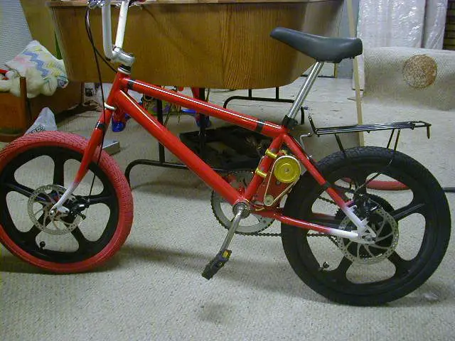

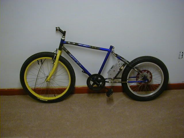

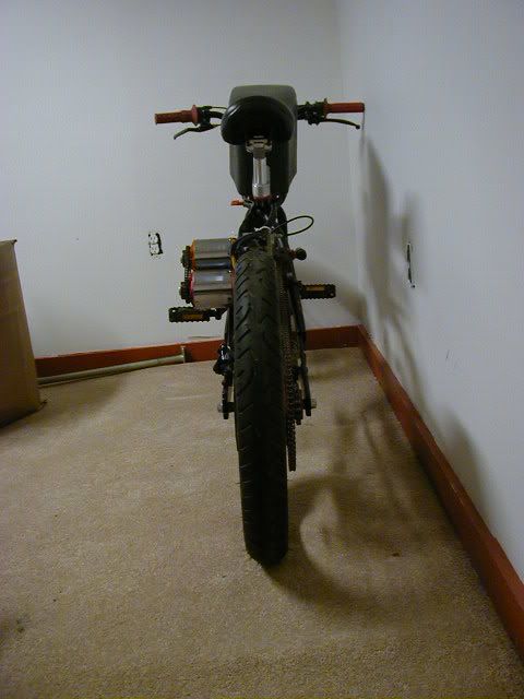

a mocked up test mule:
this bike has a 2-speed gearbox-16" moped rear tire streached frame & modifed geometry to make it handle properly

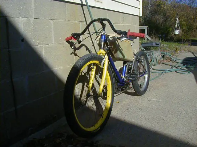

Here it is in the sunshine, I am not liking the drop on the bars...a foam & fiberglass battery box whipped together in an attemtp to make a race in detroit..epic fail (botched the rear brake post spacing & wouldn't make it through tech...after pulling an all nighter build session :(

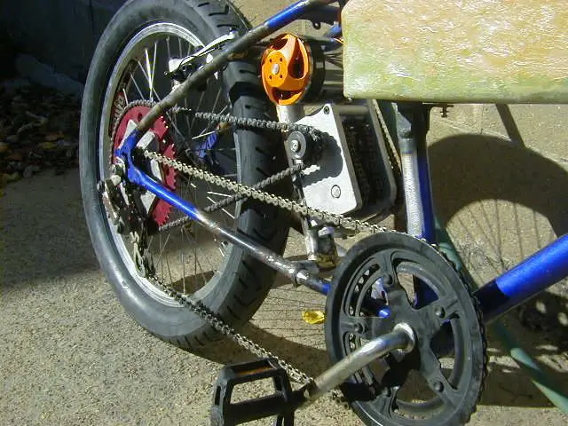

Here are the drive lines...as sits its powerd with an 6k watt 80mm outrunner motor (roughly $100) I like #35 drive chain as its aforadable & everywhere..i can pick up master links at menards. twin freewheels on the rear sprockets give total independance to the drive systems. I can pedal...I can power..or any combo of the 2. Hot off the charger this bike tops out at 52 mph (gearing limited...with my hefty 230 lbs aboard) Ultimatly my modified china girl will reside in this frame.

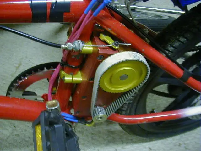

Here are close ups of the bike tranny:
This is the complete power package in my hand. You can see the tiny motor at the bottom of the assembly. at maximum load it produces just over 3hp. (no. it wouldn't survive long at that loading) But will push me along all day at 25mph & drawing the equvilent of 3/4 hp.

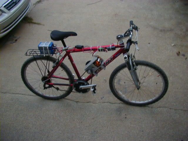

This is lost sheep's bike. He started running 22v 20ah pack & range at top speed with no pedaling is about 15 miles....He has upped the voltage to 30v (controller max) & is quite pleased with the performance.

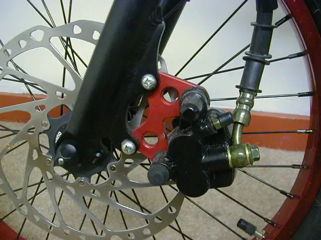

Got to give a thanks to Jim (creative engineering) for the directing me to the front brake caliper. Way better than a bicycle caliper & less expensive to boot!
