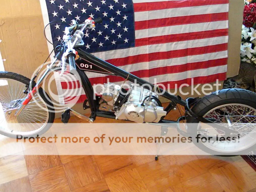

Here's a Big Lowrider frame with a motor in it so you can see it fits with no mods...
http://www.bicycledesigner.com/defaulthome.asp?Main=/datasheet.asp?PartNumber=514705
