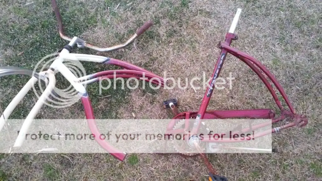

I found this bike in a pile by someone's trash can. Flat tires, rusty, bent wheels... I loved it instanly.

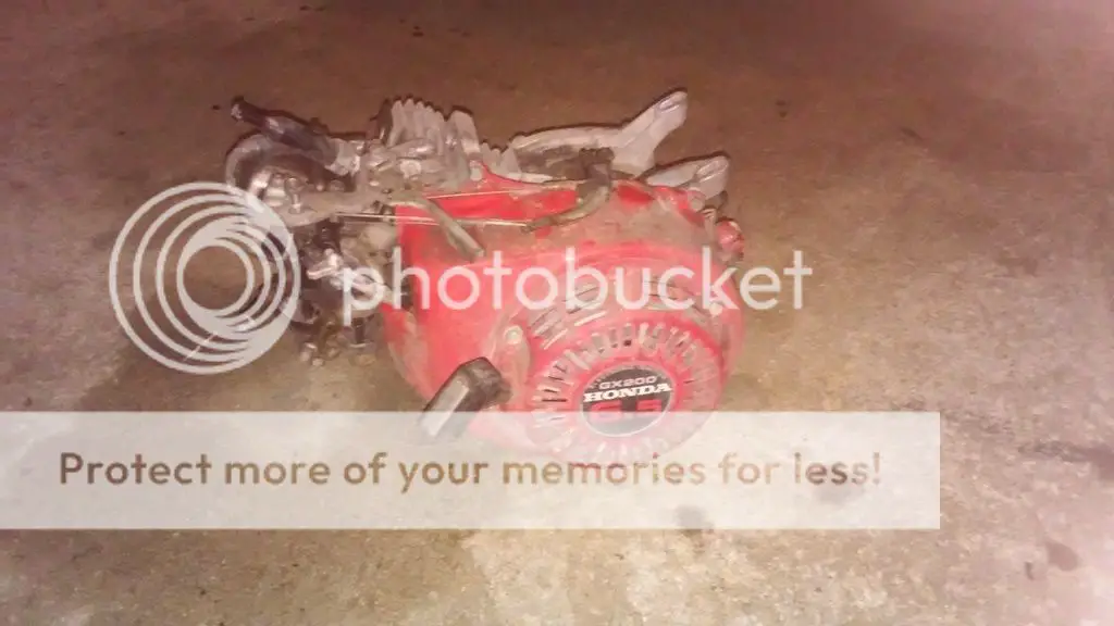

And speaking of trash! The things some people will throw away are ridiculous! Like the GX200 i decided to put in it.
So here i am with a free rusty bike, and a free gx200. After thinking about it for it a bit, i made up a challenge for myself. I'm going to build this bike... for free.

Here's a google photo I found of what it used to look like before I started hacking it up.
I guess it's a Thruster city cruiser (apparently Kent made them??) It seems pretty old, but the frame is made of good material at least. Welding on it is easy enough, so it's not just Chinese pot metal. I may need to reinforce some welds here and there (there's a big sticker above the bottom bracket that proudly proclaims that it's all tig welded). But the frame looks good enough to use!

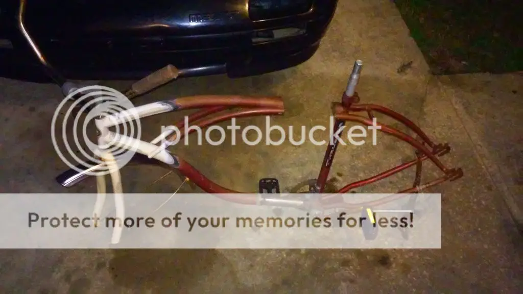

I did a little more frame work. I'm not really the best at welding thin metal yet. I am pretty good at blowing holes in it though.
Frame is all welded up, and so far I've made $260 from neighborhood throw aways. Weedeaters, bikes, leaf blowers, pressure washers, etc. So the first thing I bought for Mr. Shackleford was a new set of sneakers.
