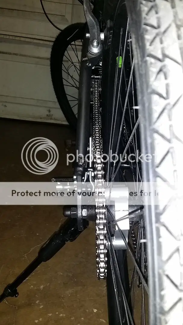

I cleaned the bolts and there ok. There's still quite a bit of rust in the adapter holes though and it's thick, more than just surface rust. I've used CLR and gas, and there's still some rust. I'm gonna keep cleaning and hope for the best.
I don't see how there can be rust in the adapter holes, unless it came from the bolts. The adapter is aluminum and cant rust. Just clean it the best ya can, throw a little blue Loctite on it and yer good to go.

you may need to source longer bolts to do so, but if you do not have enough lateral play you can use some washers to shim the spocket out more, a serious advantage of this type of adapter.
also fo the rust inside the bolt holes you should be able to clear that out with a bottle brush and water. the clamshell is made of aluminum so any rust in there is just acumulated from off of the bolts.
just make sure everything is nice and dry before you put it back together, that rust on the bolts is probably from water sitting on them or the adapter during shipping.

I've got the sprocket on and it's true all away around, im happy with the adapter. I'm totally going to blue loctite it all down. Sorry for the delayed response I painted the bike and am still putting on the finishing touches.
