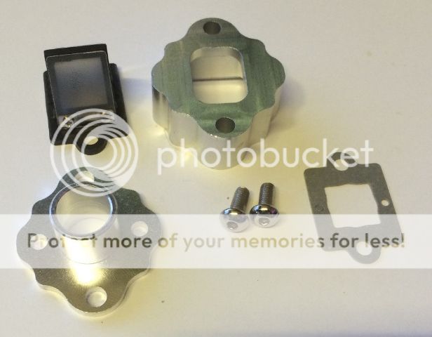

Thanks for the info Theon. I have read a lot of different information on these. Here is a photo of the other kit that people swear by which is the "Motorized Bicycle RSE Reed Valve - for 32mm Studs THE ORIGINAL!" 160.00 on fleabay. Just trying to see if anyone else has used either one and I guess what their impression is on them. First photo is the RSE and second the cheaper version I picked up. Anyone that has used these let me know what you think. It looks like they both use fiberglass reeds. Hopefully it does help out on top end as well. Hey as a heads up I just read this on piston bikes info on reed valves that "Don’t worry if any of the petals break and go into the engine, we have purposely designed them to be made out of fibreglass & it will not damage any internals of the engine, they are available as a spare part if ever needed." So that question is answered. Once again anyone using these let me know what you think.

Like Theon said, these reeds are off a DLE 30cc RC model aircraft engine and they cost about $8 to $15 brand new, the reed block and adapters in the kit are what make these work on these engines. The fiberglass reeds will last a really long time and if they do break, they'll get ate up by the engine before any damage to the engine could occur. That's the beauty of the fiberglass or carbon fiber reeds.
I know RSE does make another reed valve kit with a slightly larger reed I think from an 80cc DLE RC plane engine, not all sites sell this reed and they do cost more, but for these kits, the genuine and the knock offs are about the same, and the reeds can be replaced on the cheap with genuine DLE reeds if they do wear out.
As far as top end performance with this reed, it's a fairly small reed but it can perform if you do the piston mod so you can get full intake duration, they'll work bolt on and go, but they really need the piston skirt mod (just a window in the skirt) for better top end and to take full advantage of the performance gain, this is easy to do with a drill and a dremel.
I read the same thing about the knock off, so bought the RSE for $59 shipped. Nicely made piece. I have not done the piston/porting mod yet. My goal was a smooth running torquey engine with no desire to mod for top end. Mine is far from broken in also. Running the reeds dead stock shows an improved idle, with good bottom end and no 4 stroking. I removed the reeds and ran it stock and it 4 strokes in the lower and upper throttle ranges. Its still too early in the engines break in to make judgments, but the reeds do seem to enhance low to mid throttle. Will do the necessary mods after break in.
