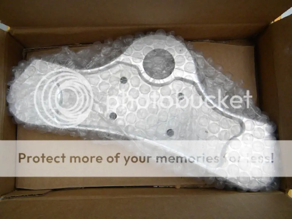

Update May 21, 2013
For those of you following my Stretch XL Chopper build, I've had this build on hold, waiting for Pedalchopper's next run on Extra Wide Forks, aka Wide Ride Forks ( http://www.pedalchopper.com/wide-ride-forks-fat-boy-style-forks/ ) these forks are awesome with tabs for front disc brake, I'd suggest in future production run's that the Top Yoke not be milled which would allow builders the choice of using Stock Schwinn OCC Chopper Riser's or the BMX Handlebar clamps.
Just received confirmation from Jim @ Pedalchopper.com, my requested Top Yoke without the milled center section is in this next production run, which will allow me to use the stock Schwinn OCC Chopper Risers for this build!
Here's what the forks look like with the Top Yoke milled, and this build has the BMX style handlebar clamp to hold handlebars in place, with this style top yoke risers cannot be used, the top yoke must smooth to allow use of Stock OCC Chopper Risers.
As you can see in below picture the center of top yoke is milled, which will not allow the use of Riser's, it must be smooth without the indented / milled center section. So as promised by Jim @ Pedalchopper.com, he's finally having a third or fourth(?) production run of the Wide Ride Forks, with a new Top Yoke for my Wide Ride Forks to accept Stock Schwinn OCC Riser's.
These are the Moon Bars / Beach Cruiser Handlebars that I'm using on these new Super Fat Tire / Wheel front forks.

Update May 21, 2013

Thank you, Jim @ Pedalchopper.com just checked tracking information should be here for delivery Friday May 31, 2013
Can't wait to put the new top yoke which accepts stock OCC Schwinn Stingray Chopper Risers / handlebar clamps on my XL Chopper build, here's the link: http://motorbicycling.com/showthread.php?t=18970
I will be using Beach Cruiser Moon Bar's for a more laid back riding position, on these Super Fat Wheel front forks.
