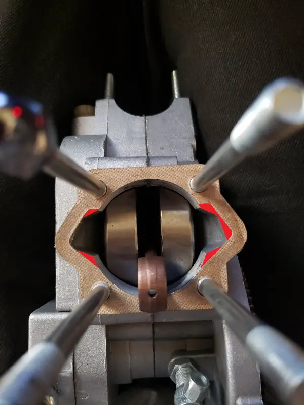

I just use a couple long bits to reach the transfer ports all the rest are regular bits for cutting aluminum, does not take long to port for me it is like 10 minute job start to finish. makes the engine run good under load.

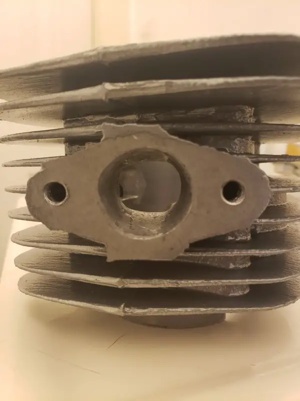

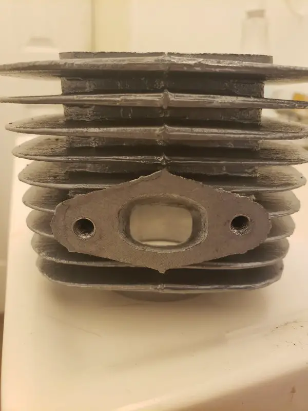

That's the porting I've done so far, I know the intake side will need more but I have to get the reed kit first.

widen the ports at the cylinder side both intake and exhaust, that jug you have is a good jug the ex port needs no porting at the muffler side just at the cylinder you need to widen it. the intake same thing you widen it as much as you can, then blend ith edges so the piston ring wont hang up on any burrs. the transfer ports have a ridge to remove and that is about all you need to do.
