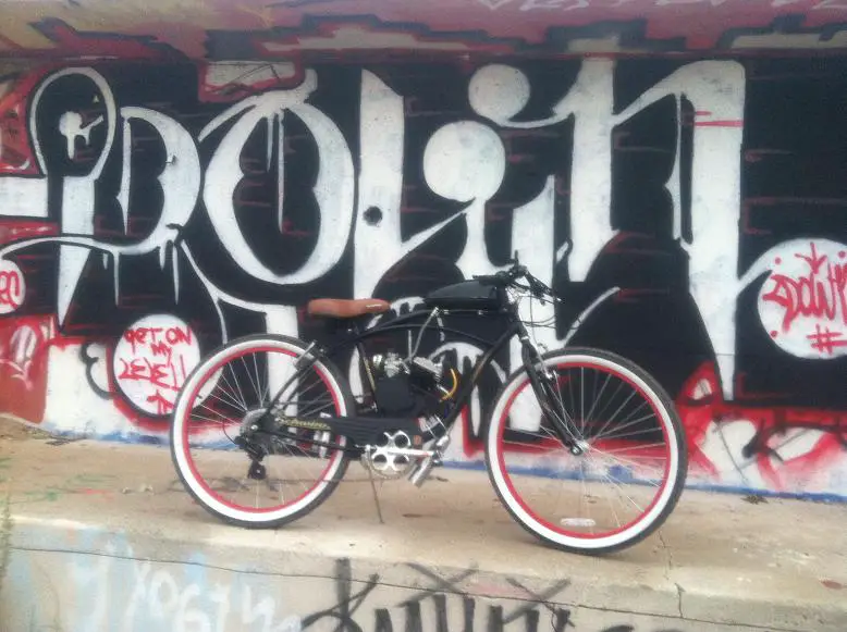

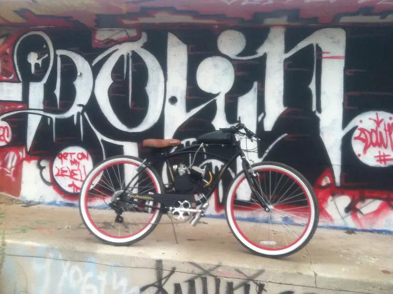

Hay Gary, what will the wheels look like? lookin good. i vote red wheeles to match the seat rails! people love my black schwinn with red rims over my blue/ tan Cranny
click me
click me
I saw your bike today and I was thinking the same thing. I really like those red rims and am thinking of doing the same thing. I have some red M/C grips coming and I think another "Splash" of red would look sweet!

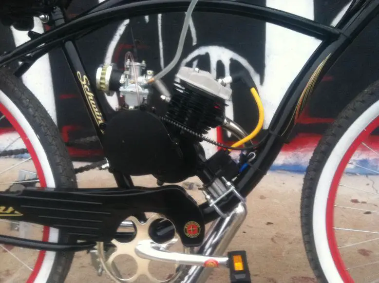

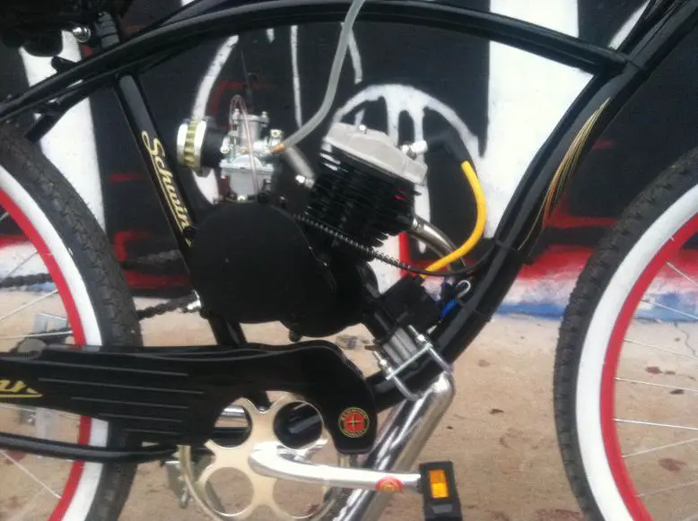

This is the intake and it's pretty bad and in no way can I totally clean it up without making a new intake. That's a little more work than I'm willing to do but just cleaning this up may add 1/10 of a hp. Note the edge on the intake flange where it's welded to the pipe.
Gary Harris
Jul 31, 2011
86
Houston
The base gasket was installed upside down.
At TDC there is a LOT of piston skirt showing. This area will be removed to allow more fuel to get into the crankcase.
And the transfer ports could use some cleaning up.
Gary Harris
Jul 31, 2011
86
Houston
Got a little more work done today and I'm debating weather or not to split the cases and match up the transfer ports. They are pretty bad and I ain't sure it's worth the effort.
Cleaned up the exhaust port a little.
The flange and the exhaust is just too bad to do at home with a Dremel. Ill have to take it to work and put it in the mill.
Got the bottom of the skirt cut.
Got the head partially polished and may leave it as it is. If I do any more polishing I may be removing more material thus reducing compression.
