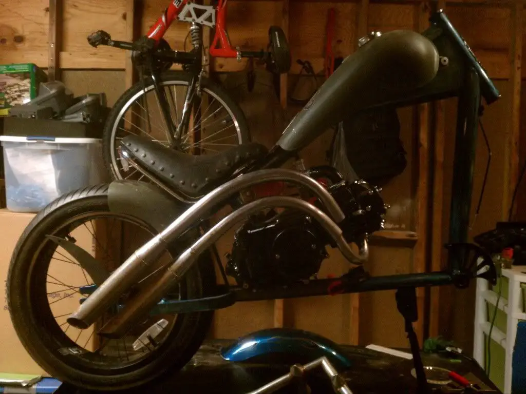

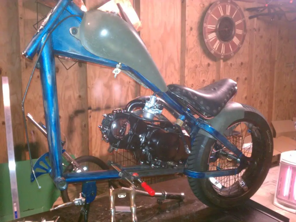

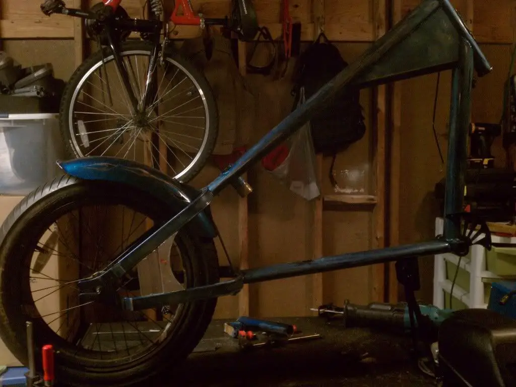

Update to my Stingray Chopper build.
Getting it ready
And we begin. Got 125cc motor in today
Still have a lot of work. Pipes & handle bars have lots of rust, need to paint (not sure if i want to go w/ the flat olive green, flat or satin black, still need to weld.
