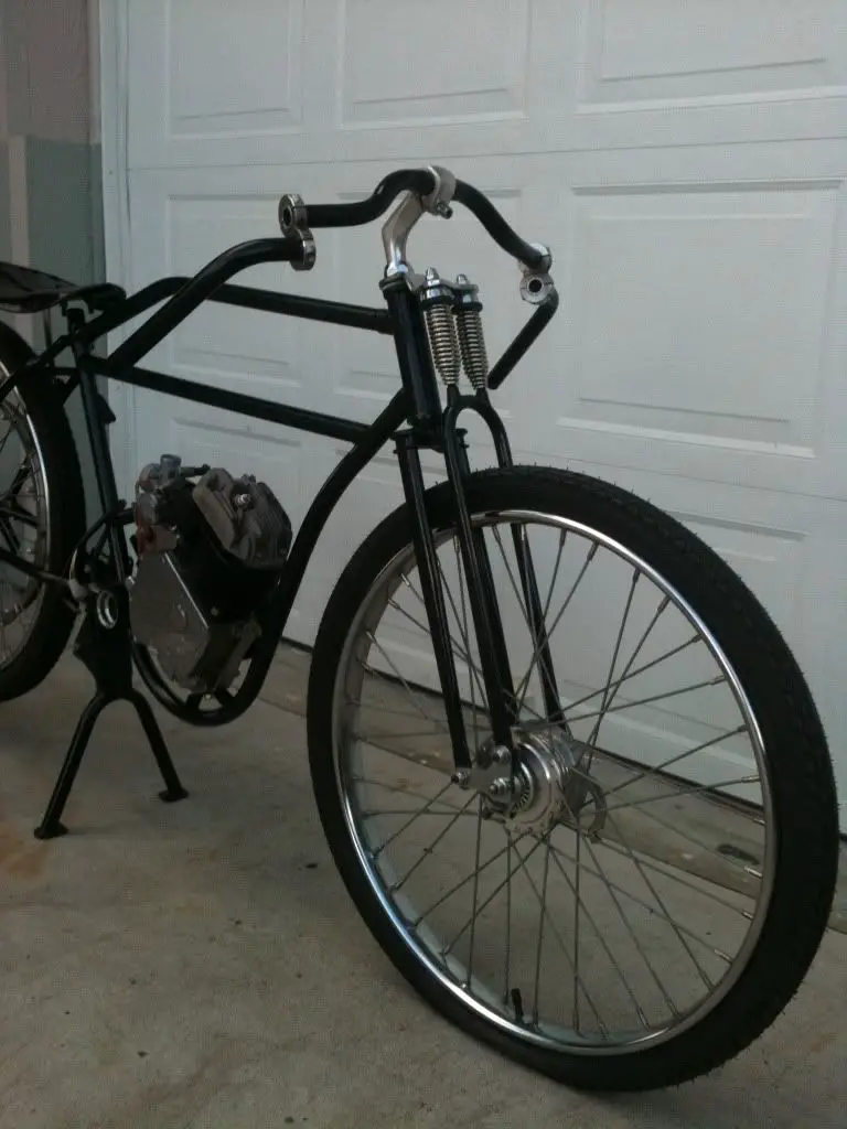

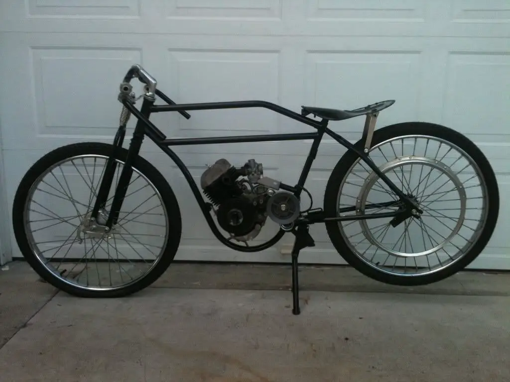

After seeing Pats Design Insperation post i've decided to post a picture of Sportman Flyer WZ001 under construction.It was intended to be a boardtracker.After getting the bike in my garage and throwing some parts at it this is what i ended up with. The only change to Pats work,which is top notch i might add,is to the clutch spring bracket.Pat had it welded to the frame verticaly which required stretching the spring and hooking it in the bracket. I cut it off and welded a new one on horizontaly and attached the spring to a threaded eye bolt making it a breeze to install and adjust the belts.I believe Pat said he would be using a similar arraingement on future builds.

Definately a cool looking cruiser, Doug. Those forks are nice. How about a close-up picture? The Panther looks like an interesting project as well and the modified down tube will open it up for a Whizzer engine nicely. Oh, my brother has been working on a Hipo Whizzer intake manifold. Maybe he can make a couple extras for us.

Very Kool Kruiser Doug, Pat just finished up my WZ frame and should be at the house when I get back from this eastcoast run.... ;-)
ChopperDave With the autoclutch the belt i used on the front was AX27(29 inch) and rear wasAX66 (68inch).The rear is quite a bit longer than stock because the engine sits lower and Pats idler.

What kind of fork is that?
