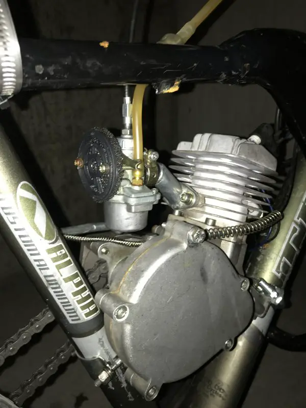

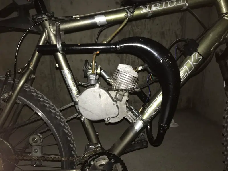

Hello,
I am working on improving my motor bike currently. It is very reliable and will always start. Last summer I could easily go 35 mph at WOT but now I have trouble doing anything above 12 mph. I am not sure what is going on but these are my symptoms and what I have done to try and fix it.
Symptoms:
Low RPMs sound good and push the bike forward well. Anything above the lower third of my RPM range my bike gets slow and sounds extremely loud. It sounds as if the combustion is trying to push hard but the bike RPMs drop dramatically. If I keep my throttle at WOT I will actually start slowing down as I ride. My Spark plug is super wet and dark.
What I have done to try and fix it:
I have checked for oil leaking out of the jug/piston/exhaust/intake gaskets. I did find a leak on the front of the jug/case gasket, so I replaced it solving that leak, still having my normal problems though. I place my jet pin to the leanest setting with the C clamp and I still have a wet spark plug.
It seems as if when I open my throttle all the way the air/fuel mixture is to rich but I am unsure of how else to make it leaner with the jet pin dropped all the way down.

Hey, welcome! Nice build
--> Check for a blown head gasket. Start the bike and put your hand down around the head and see if you can feel any air shooting out when you rev the engine, you could be losing compression. Head nuts should be torqued at about 15 foot pounds.
--> Remove and clean your carb with carb cleaner spray let it dry, put it together and try it again. Also, see if it will run good without the air filter, they can get blocked over time sometimes.

Thank you for the response and the compliment!
When I ordered my motor I didn't realize this but is a one piece head/jug so there is no head seal. There is a seal at the bottom of the jug and I just replaced it. I will feel for leakage still and check the carb out. I feel like it is lack of compression though too, not sure where though.
