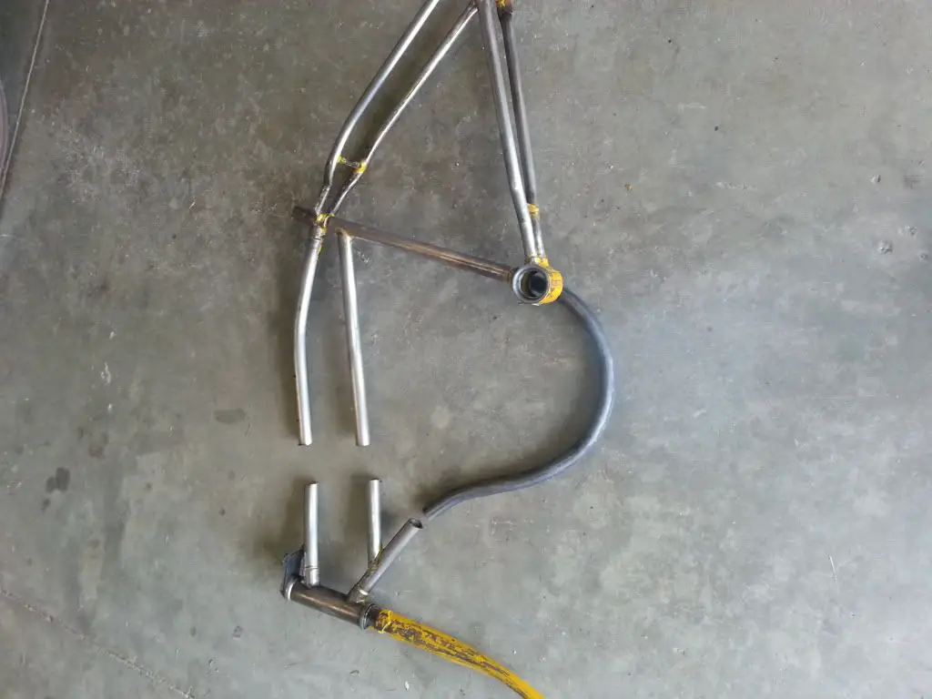

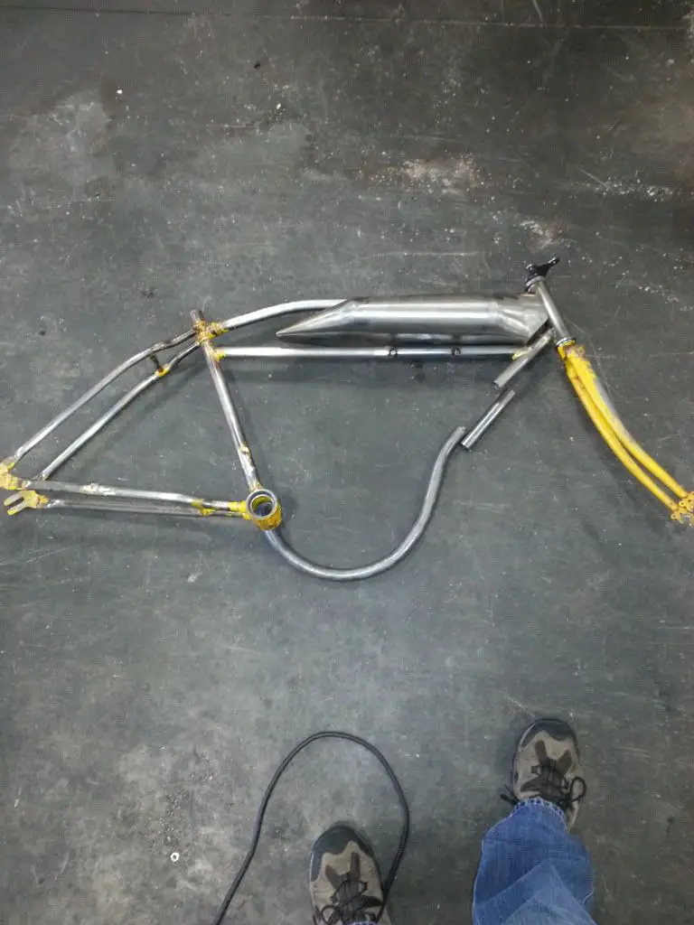

OK Truckd.... maybe i needed a little kick in the pants. I pulled this out of the corner again and surely commited myself to the new path its going to take.
Inky.

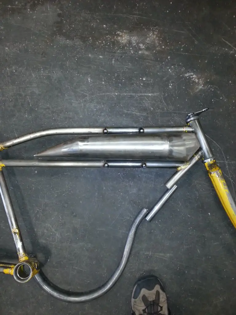

what are you going to do with tank ? I do like where your headed with this and I'm contemplating doing the same to mine (Worksman)
Well I gotta do what I gotta do....... it has to be cut and stretched as well. It kind of pains me but its for the best.
Man I hear Ya, I gotta do the same thing to and the tank has a custom machined turned pattern milled on it.
Nice job on yer frame, keep it up!

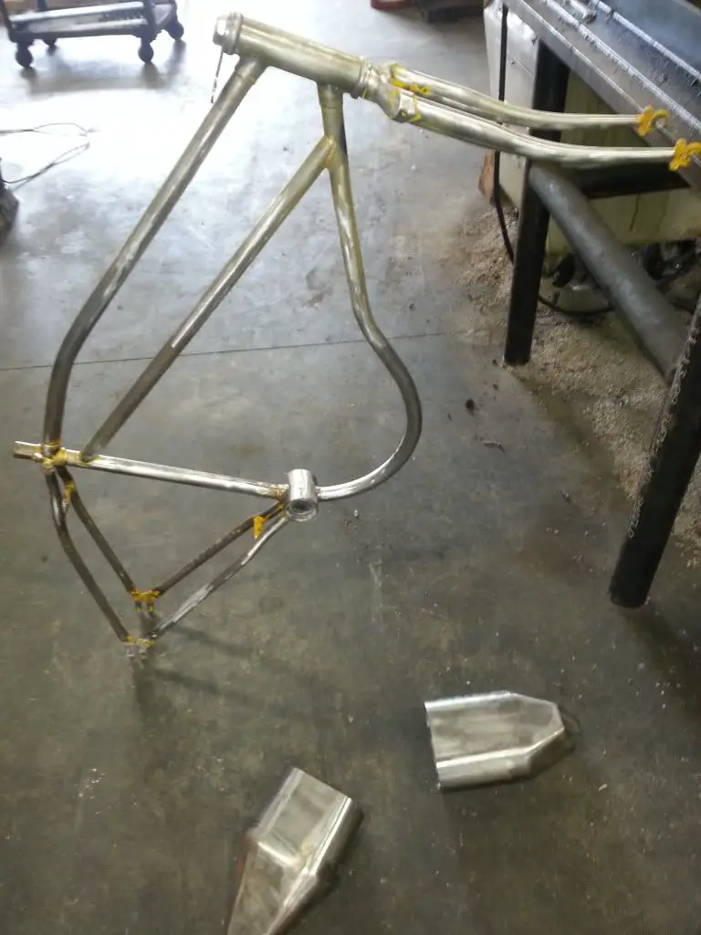

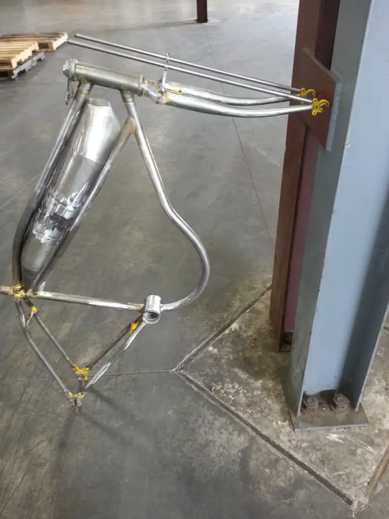

put in a couple more hours. didnt get real far but its coming together like the little voices in my head tell me it should......
NICE! VERY NICE!

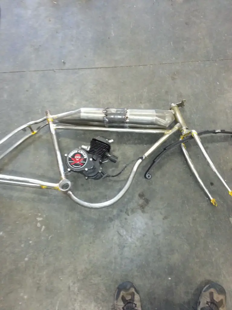

Center up that engine, move it Just a little forward (NOT MUCH!) 1 1/2"-2" Max. that will give you Crank clearance and allow you to create a Faux crank case like on the Redskin then you can hide the CDI in it too, run a couple of aluminum tubes for wiring and keep the simplistic look of the Indians .

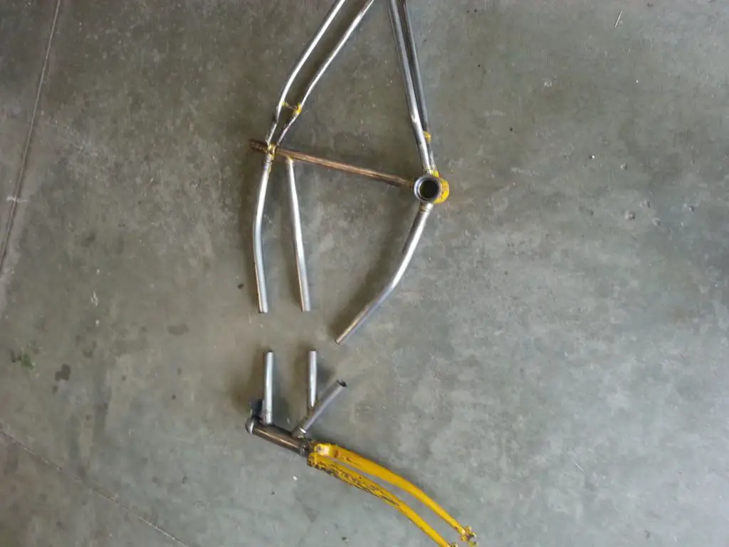

Are you going to use the whole spring? maybe we could work something out on the other half of it? those Worksman forks are cool looking! got a set from my buddy Dan, they are more of a Reading Standard style, but I like em they got Character.
PM me if we can work it.
Motor was just layed in until full mock up. Have the trus fork near complete also. As for the leaf... in order to clamp it stable it gets cut off past centerline so the remainder is not good for anything. Thanks again for the push. I am rejuvinated

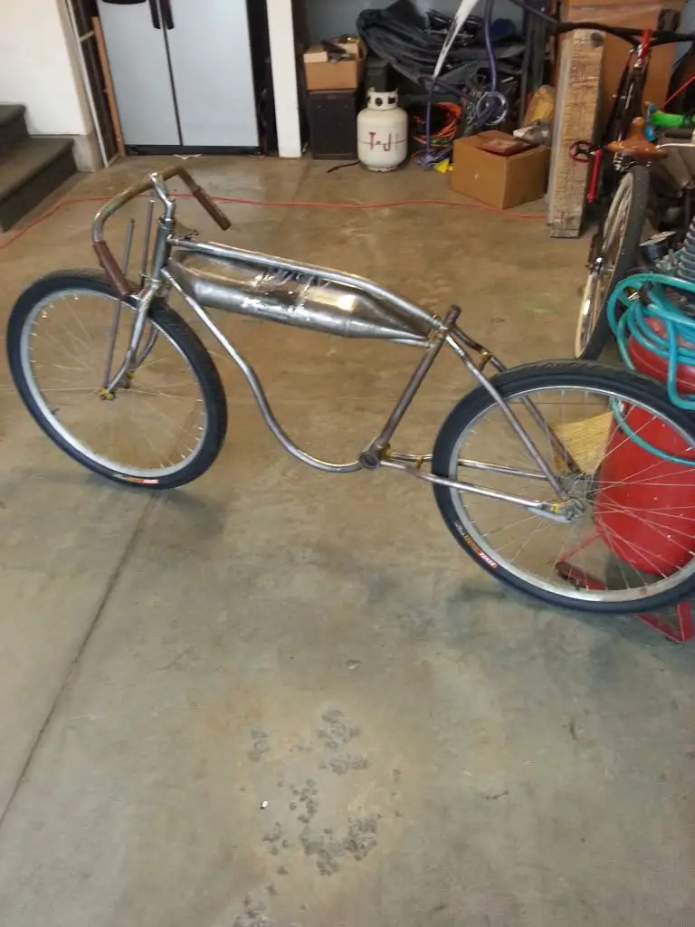

What a great build you've got going, Everything Looks Good! Tank is fitting rather nicely I see and judging by your post's fairly rapidly too.
Wow sick bike.. really appreciate the custom fab work...just started building my own and this thread has given some much needed inspiration... keep the pics coming.
Ink we need to some some progress pic's, well I'll settle for a progress report if ya ain't got pic's LOL!.
Can I make a suggestion, Get a Schwinn Varsity Goose neck, you can get em pretty cheap from EBay.
I dont really have much of a report so far. I have messed with cleaning up the welds some and this friday will drill mounting holes and bung hole for the tank. As for the neck and bars... thats all pending. I have tons of parts to choose from so I am sure something will jump out at me. I will surely post pics as I move ahead
