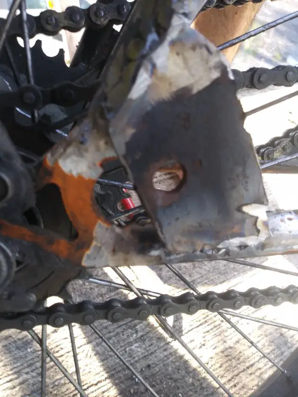

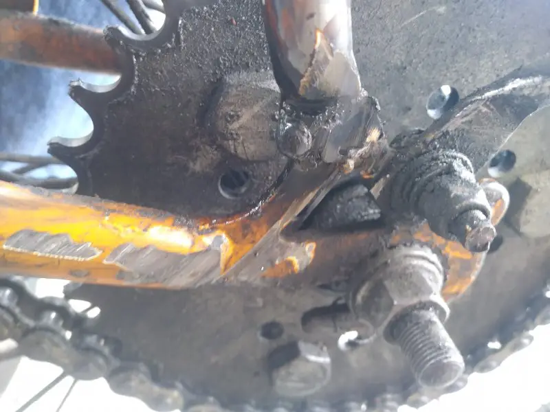

I am 5.10 and had to raise the bars to get the bike to feel good while steering around tight turns without so much effort. Was a wise move along with a wider bar. but my frame has maybe 5000 or more miles on it and it just cracked the rear lug this morning. I repaired it but now I need to add metal to the area to keep this from happening again. it broke as I was heading out this morning but I welded it quick cause that was not going to stop me today. Been a good frame last 9 months of abuse.

add a triangle to the drop outs on each side just in front of where the rim bolts up. will prevent, or at least retard cracking in the future. makes it really tough and spreads the load out on the drop out tubes.
It’ll break again. Put a couple gussets as recommended by Jimmy^^^. On one of my builds I went and braced the entire rear end with c-channel and gussets as I was getting a crack every 2 months riding about 1000mi a month. It stiffened the frame up a lot but soon after I snapped my first rear axle. 5000mi is a lot for a 66!

Tony01 has the right idea. I would also use a Oxy/Ace braze weld, the weld looks like a stick welder was used? That's the weak
point in using these bicycles with motors on them and lay off the power in turns helps.

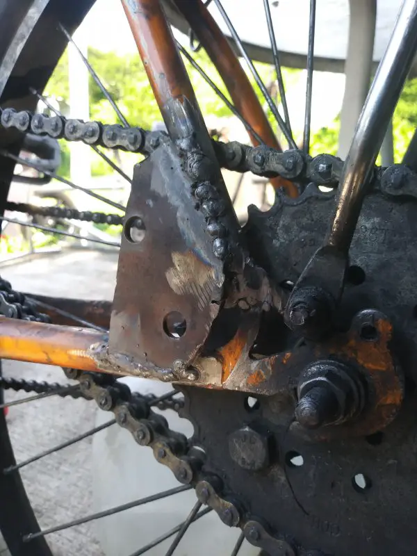

it is a mig welder but no gas used, flux wire. searching now for some steel to weld on. might cut up some lugs off a trash frame to weld on.
will post up what ever I weld on.
found some steel laying around the right thickness got it welded on already.
Nice. Yep that’s fluxcore... like boogers under a church pew. I have a DC fluxcore welder. With a couple upgrades and anti-spatter spray on the visible stuff I get pretty good looking welds.
I don’t know the micargi frames too well. Far as cracks with 212 vs 66 I can say the 66 cracks are mostly from vibration. The 212 doesn’t vibrate anywhere near as much but its torque will break parts. No good cheap options for motors. Wish HF made a 120 or 150. 66s break down often and 212s break parts often.
yea I had the wire speed to high on one side slowed it down for the other side. I could make it look wonderful but this beater frame has alot of beating on it already. I crashed 3x with it already. countless other small indidents. Everyday something new takes a dump. sometimes I wonder about the head tube just taking a vacation on me.

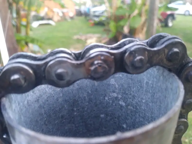

GOT THAT RIGHT ABOUT A 212cc! I was....going into town this morning and got 3 miles out in the
country and let up on the throttle on a down hill grade (not steep) and heard a pop. I looked down at
the chain and it was missing laying in the road. I thought the keeper might have came off instead the
chain snapped while I started coasting. This Chinese 415 chain is no good and I am going back to the
41 from the BigR farm store, at least it's decent Japanese. The 49cc could stretch the Chinese 415
chain and I've never had it happen with the BigR chain. I am seriously thinking about pulling the
