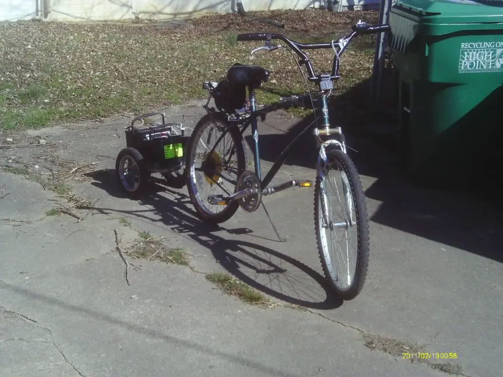

I built a home made trailer that is pretty small considering it is hauling around two automobile batteries. What the heck? I am sure you just asked. Why would anyone do that.
I just wanted to see what a car battery would do. I was in the midst of building a Trike because my balance isn't so good. I needed something I could ride on a trip that might run five miles at the most. I got the Etrike finished but before I even tested it, I got side tracked with the auto battery experiment.
Here are the elements I have now and what they do.

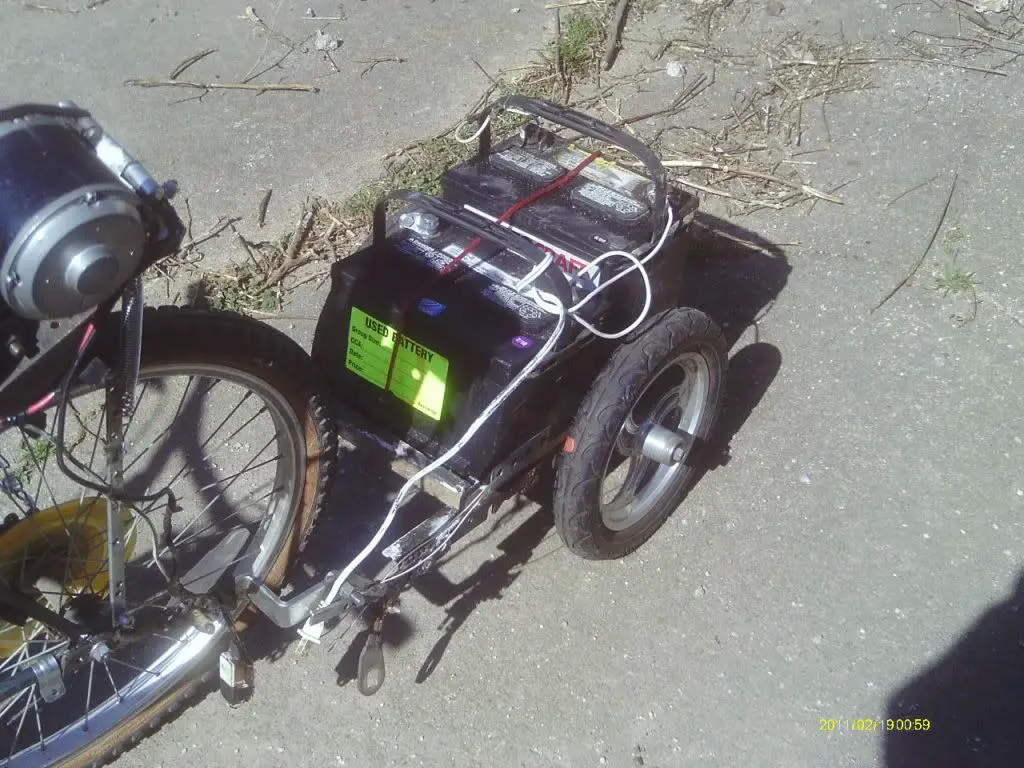

Okay after rebuilding the battery trailer a couple of times I have two auto batteries (both used) sitting on a trailer made with two electric scooter wheels and tires I had laying around. The trailer bed it about 9.5" x 12 inches. Once i got all the drag out of it, the effort required to pull it around isn't too bad.
I have it attached to a two wheeler with a friction drive motor on the rear wheel. The motor is really the rear assembly from an electric scooter sitting on top of the rear wheel. This isn't about the bike though, it's about the batteries and maybe a little about an overall ride.
Okay so after having tested the bike riding around the neighborhood, I felt pretty confident that the outfit would work well enough. So this morning, in spite of a nasty head cold, I took off on a ride in the real world.
When I pull the batteries off the charger the pack reads 25.75 maybe a little more. I left home pulling the trailer up a gentle hill with my bike. Top speed is a blazing 6 miles and hour. I have the bike geared so that I can pedal it while the motor is running. There is no throttle. The drive is on or off. Pedaling helps with the battery drain and to keep the heat down from drag.
So when I got to a long downhill section of almost a mile, I lifted the motor and coasted with a little pedal assist. When I came to the end of the downhill section I dropped the motor and off I went, still pedal assisting it. Now when I got to what I call bike killer hill, I was able to run the motor and pedal assist to the top. It did cause me to do some heavy breathing but I need that. I could never have made it up that hill, not even a fifth of the way, without the engine.
So when I got home I read the pack and it was 25.10 volts. At 24.5 it begins to sag so I had a couple of more miles in it. I wanted a bike that I could ride to the store, or ride for exercise this is it.
