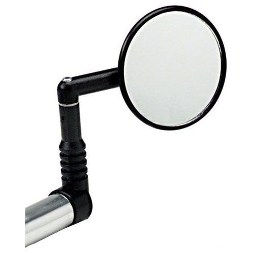

I swear by this model:
http://www.amazon.com/Mirrycle-MTB-...keywords=mirrycle&refinements=p_72:2661618011
