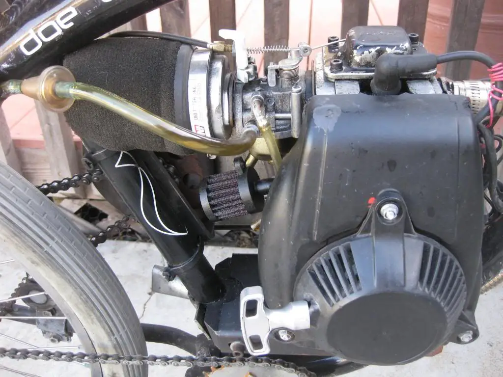

Using an adapter from AGK, I run the UNI 2-stage foam filter.......it's high flow. I believe it's the 1-3/4" UNI.
dnut
Whoops, the adapter from AGK is more like 2-5/8 to 2-3/4" ln diameter.
