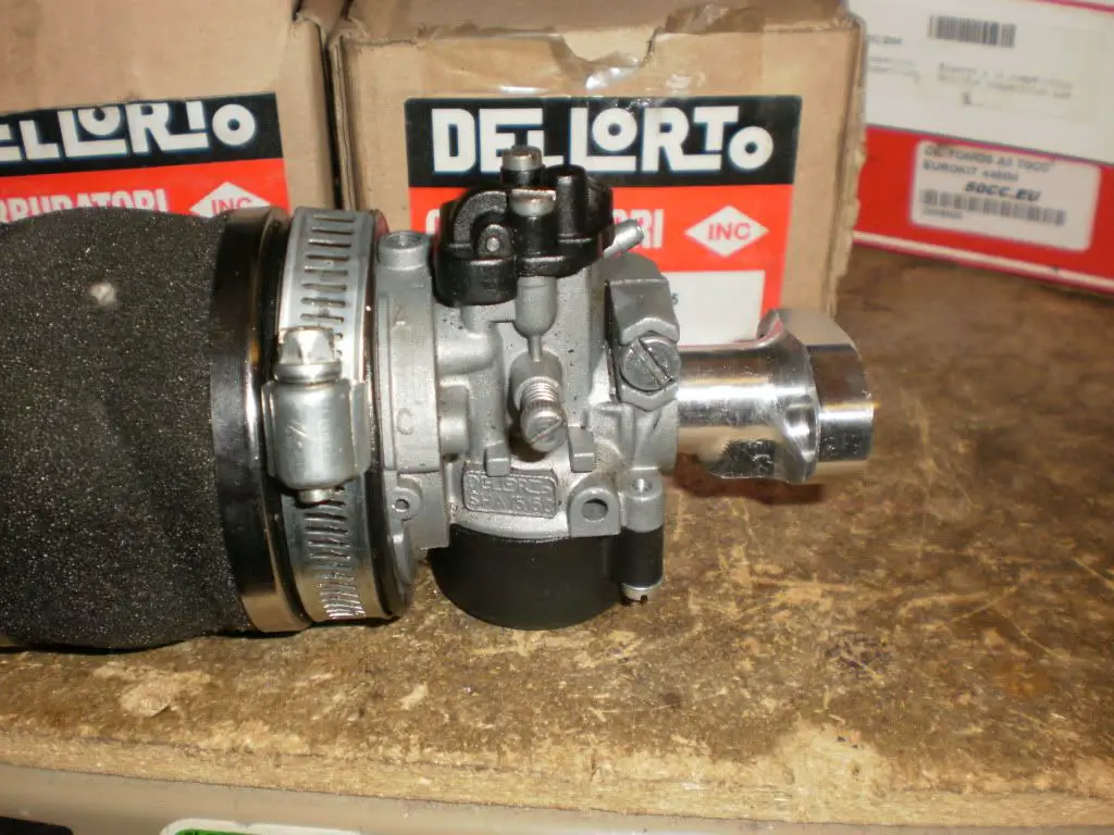

The 15.15 dell SHA fits perfectly with the maniac billet intake...so Id think it would fit a stock intake too but why bother with the crappy stock one...
This would be your cheapest choice...make sure you get a bunch of jets from size 65-80 Also i would upgrade the stock air filter the dell comes with...
This is the one with the lever choke....
dellorto SHA 15.15 carburetor with lever choke
SHOOT ,I just measured the maniac billet intake at 13mm... What the heck I thought it would be at least 15mm to upgrade to the 15 mm CNS carb....
It makes no sense to put a bigger carb on a smaller intake ....Your not going to achieve anything.....
Now Im a little p.o. they should have listed the size of these things and theres not much room for boreing..... Now i got a 15 dollar piece of scrap aluminum :(

I got out a clear ruler with millimeters and carefully measured everything-
the port- the actual opening- on the NT Speed carb is 14 mm, and the old stock carb is 13mm- I believe exactly as advertised- 1 mm bigger on the newer-
the mouth of the Creative Engineering billet is exactly 14mm- I reamed the old one to 15 and the newer one to more like 14.5 mm- PROBABLY OVERKILL-
and in fact looking at it it may be better to have the 14mm sufaces match identically and perpendicular to prevent air leaks- the motor side can still be reamed slightly for more flow- the carb side is not gonna get anything.
The other thing I did was place a plastic tie BEHIND the clamp- because as I said above- it has a stop on the clamp and won't slide all the way back to totally cover the slots in the carb neck- one could file down the stop point on the carb and slide the clamp back- maybe even find a better clamp-
but this solution seems to really cover tightly the slots behind the clamp- and I've never had trouble with the clamps otherwise.
after the photo- I cut the excess tie off and you can barely notice it. Frame clearnce is even less of an issue with the shorter billet- but the float bowl is now resting right up against the cable screwdown that I already had cut down as per instructions when I put the first billet on.
So it's on and ready to test!
