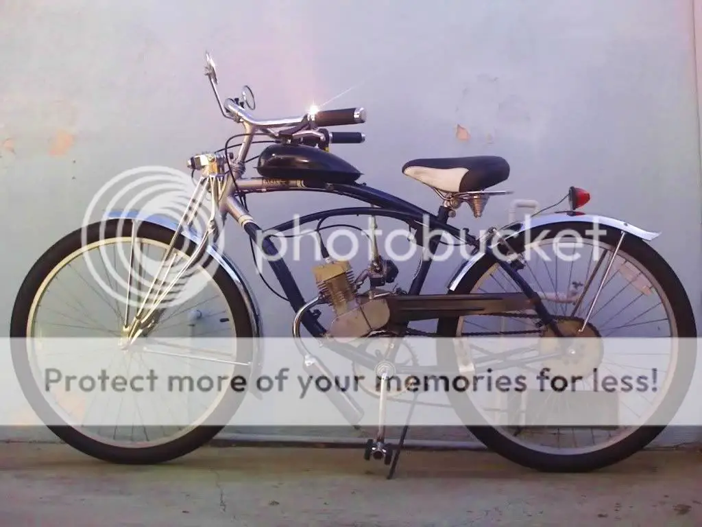

This is what I did to my Target Schwinn. 1K miles and syill going strong. But I do check it everytime before I ride. It is only a matter of time before I see crack some where. The major improvement I did though was installing the clam shell sprocket adaptor seen in the 2nd pic. I don't trust anything putting preasure on the spokes.
How is the sprocket adapter mounted on the rear axle? What keeps it in place and prevents it from spinning around the axle?
I have a piece of rubber but it isn't needed. I've gone wihout the rubber on 3 other builds. There are 2 bolts and clamp the shell down. You can see one of the large holes on the second pic. Then there is a spacer that attaches to the sprocket and 6mm bolts connect the sprocket and spacer to the clam shell.
