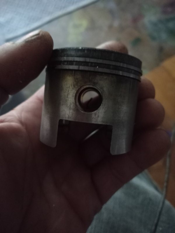

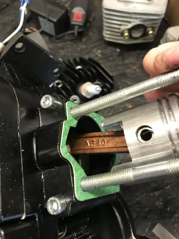

My rod has af-80 stamped on it and piston is 50mm.
Not sure what my stroke would be or anything hoping for some info on my motor and crankshaft size
I would search on ebay for that rod number, that will give you some info. Every piston I've seen for the larger bore upgrades have been the high pin type, as long as the crank you buy used the same bearings and piston it would work.

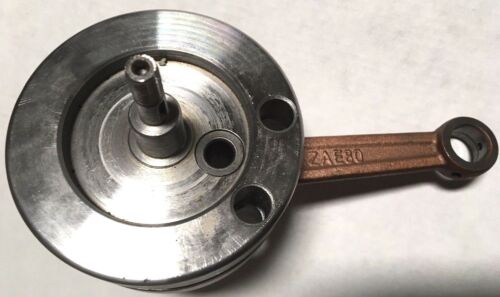

Here’s that crankshaft/rod in one of mine, it’s a 40mm stroke.
