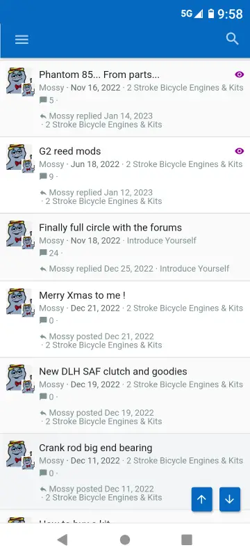

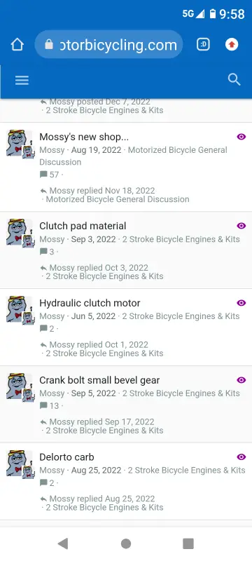

You can check out my threads there's to many things that can be done to it...
