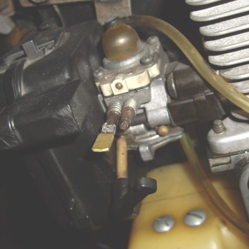

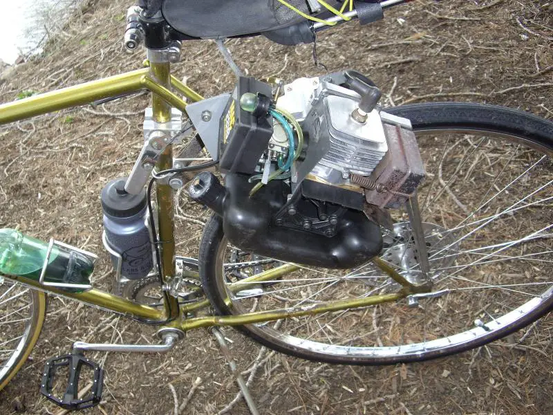

I've been running my 1973 Schwinn Continental with weedeater motors (this will be the seventh year motorized). A 25cc Homelite and a 28cc McCulloch, both with Walbro carbs. I like those little carbs - one of them I turned upside-down from factory position so I had better access to the choke lever and high/low adjustment screws.
They are sensitive to mixture adjustment. Especially instead of just spinning a cutterhead or leaf blower impeller, now they must haul my ample gut around town in all different weather conditions.
I finally got the bright idea to fasten (weld, glue) a tab to the high-speed screw (farthest from motor). My carbs have all been "old style" with plain slotted adjustment screws. Now I can easily tune while I am riding. It makes a huge difference with these little motors. I get max power and know that I am never running too lean.
I've been meaning to cut down an old screwdriver, and fit a bit of soft plastic tube to it, so that it will squeeze on, and also pull of again.
I agree 'tuneable on the fly' is the go.
That's what I used for a while. It worked but the tube has to be tight. I adjust mine by reaching back without looking and feeling for it (after a while your hand knows right where to go). But it got knocked off a few times before I made it permanent. On one I brazed a tab into the screw slot, on another I used a piece of metal tube from a broken radio antenna to hold a tab in the slot then filled it with JB weld.
I am going to do that a_dam when I get my walbro. Looks like a great idea.
