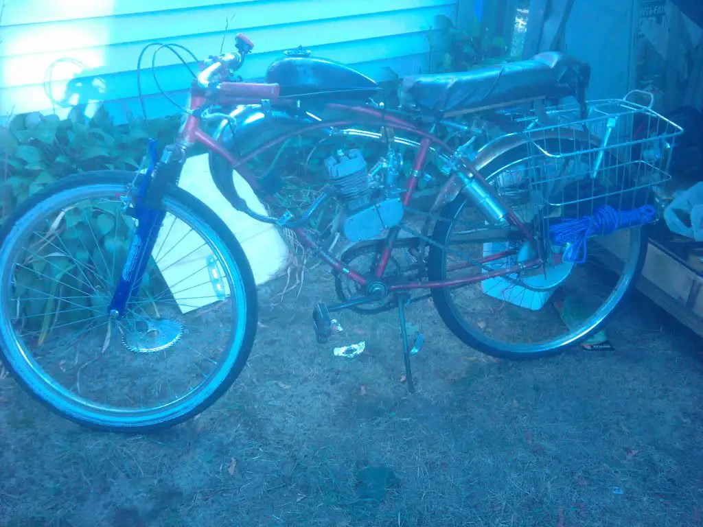

I added a small Briggs muffler and some plumbing.
Reduced the exhaust noise enough that I was able to hear the intake noise.
