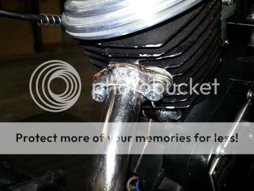

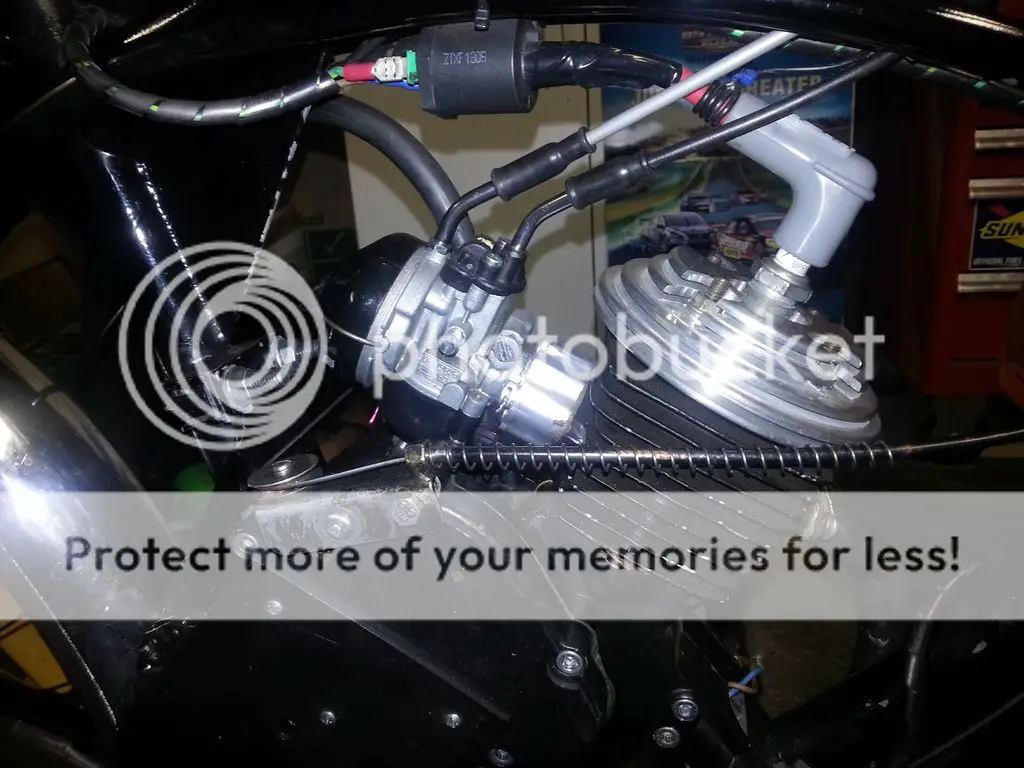

Well, after about 500km of riding. the only problems i have had is the chain falling off.
new piston, ported jug, hi-comp head, skf bearings, exhaust, lockwiring, scwarble ebike tyres.
did about 300kms on the stock carb, then tuned my dellorto sha, done about 200kms or far.
primo!!
