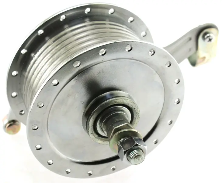

What do you think of this brand of drum brakes (ARAI Front Drum Brake)?
I just bought one of these ARAI NEW front drum brakes on ebay. Appears Random Bike Parts must have a bunch of them to sell as they are running non-stop auctions, bought mine for $27 shipped. They are 90mm.

Alright! Well, I just put this front drum brake hub together with a wheel, and it stops the bike, but not all that great... Maybe it needs to brake in a little more. But when I step back and look at the wheel, it seems like it's a little small for a motorized bicycle. I'm starting to think I should have gone with a disk brake. Oh, well, it's all good experience. First time I laced up a wheel; boy, that was hard to do!
-Fred
-Fred
3 things. 1: Yes, the drum needs to break in a little. The shoes are smooth as a baby's butt right now, and wont grab too hard till they get a little scuffed. 2: You need a brake lever that has a good amount of pull behind it. If you have a brake lever that only sits about 1" away from the handlebar, it won't have enough force to bring the shoes all the way down against the drum. This was my experience. I had a regular brake lever when I first got my drum, and wasnt getting the shoes to grab. I thought I had gotten a lemon. Someone suggested a different brake lever, and that did the trick for me. My shoes were already well broken in. 3: you will also need to adjust the tension on the cable properly. too little tension, shoes won't grab. Too much, shoes will drag against the drum and you will end up glazing the shoes. You dont want those shoes glazed. As far as drum vs disc brakes, my good friend Jay (known here as jbcruisin) has drums on all his bikes, and they are some pretty fast bikes. His '99 Whizzer (as in 1999, not 99cc) does about 50mph, and he has a 99cc Predator engine in another bike, that one does about 45. The rest of his bikes are all performance enhanced Whizzer bikes except for one 79cc tandem bike that only does maybe 30mph or so. All his bikes have front drum and rear coaster except one Whizzer bike that he recently purchased and hasn't had a chance to install a drum on yet. So if he can go 50mph and trust a drum brake, then I think a drum is good enough for me. disc brakes are the strongest, but drums are definitely the next step right below disc.
