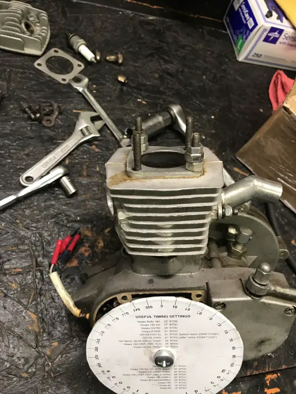

You need a degree wheel, here’s one of mine.

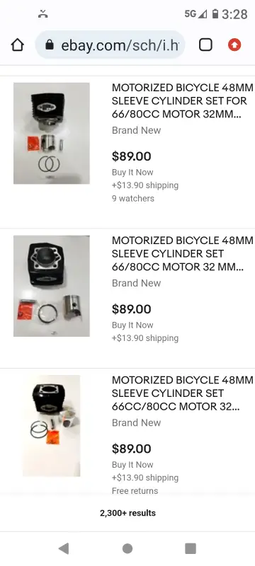

That would work if you had the exact same cylinder and everything as whoever came up with 1mm... The cylinders are all different and inconsistent... Those specific measurements leave out 'on a 2012 grubee gt5 cylinder' with a '38mm long rod crank' for example... You can buy ported cylinders from mz Miami Hi /lo hole piston port and reed... California motorbike has ported cylinders for the wildcat pk80.... Then get a few regular ones and compare the difference... Another thing about porting is there made for high rpm with a specific pipe.. if you're ported to crawl to 70mph may not be desired... Buy the jug the pipe the carb and intake and the bottom end for the effect your looking for...
