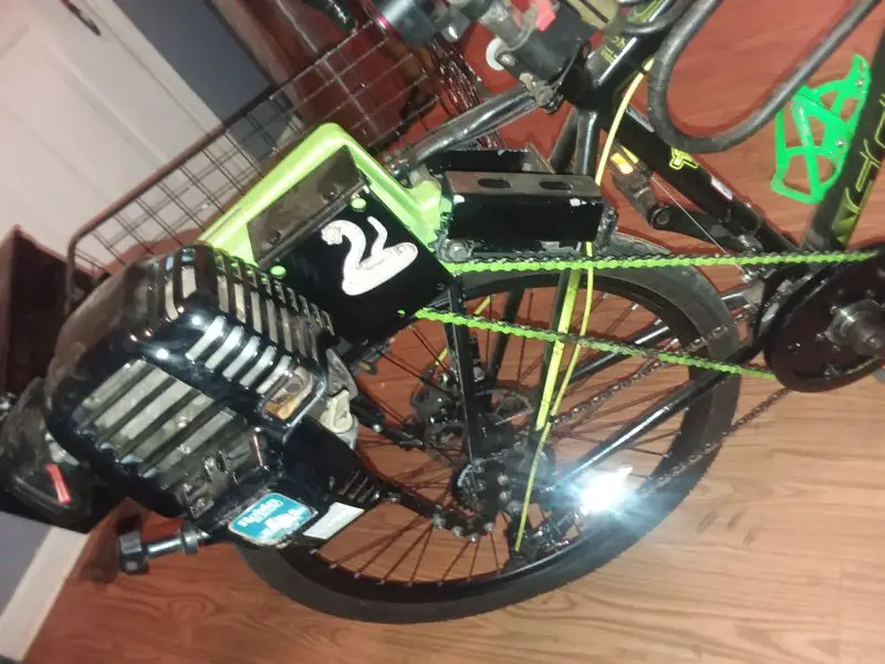

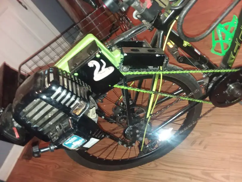

well for the cover i made you first need 2,000$ 3d printer that can color change filaments mid print lol! Most people just use stand offs from engine cover with hole in it and put plate in front of the bolts or leave it open period. Honestly after putting this on the build it went on. Not going to even bother with and cover since pants don't even come close to the thing!
Yea a stand off plate was an earlier suggestion I made similar to what's on my gearbox.

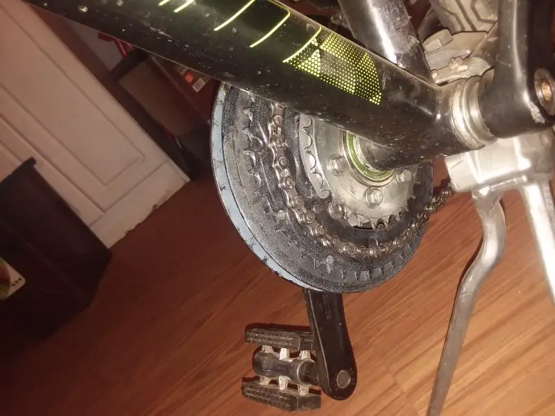

nice idea on that bicycle man! Did you build it and design it yourself?
My original was a LandRider that shifted 7 gears automatically. Retired that bike my current one is a Schwinn Sidewinder with a triple chainring shift kit. It was a Staton Inc kit.

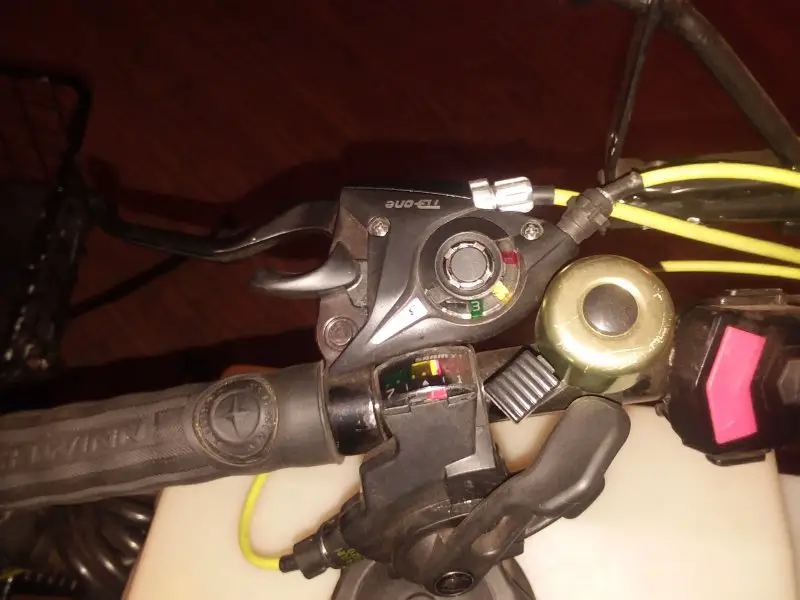

The bike gets shifted like this:
Up hill and heavy load pulling
1(1-3)
Around town general use
2(3-5)
Open road use
3(5-7)
All shifting is done with the left hand
Chainrings 28,36,44
Custom made 7 speed freewheel
(34,28,24,21,18,15,13)
Reduction range is
66.79:1 to 16.25:1.
