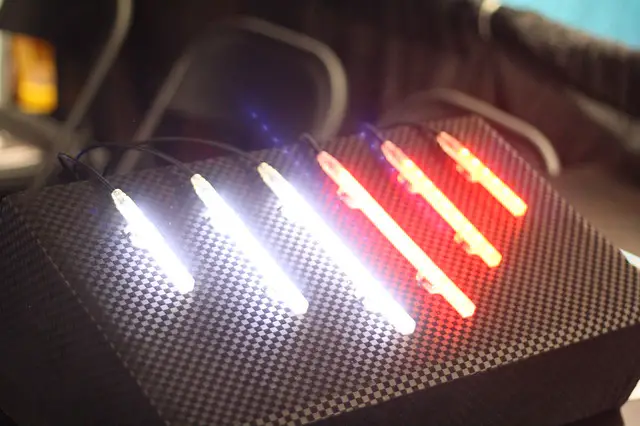

I found another system (LED by Lite) that is just on the market. They had a booth at Interbike 2011 that was profiled by Bicycle Commuters. I'm not so hot for the wireless controller, especially for something safety-related like turn signals. But I think their weatherproof 12v LED lamps could be repurposed for a robust and attractive lighting system.
These are the LED Trailer Marker lights that I'm trying to build into my system:
They are rated for automotive use, weatherproof, can run at 6v (low intensity) and 12v (high intensity). This provides me the option to operate them as running lights, as well as turn signals. A little larger than my thumb, they are light as a feather and offer decent diffusion for good visibility all around.
I agree with your traffic comments and turn signals would be a great help! I am currently using a 12v 7amp battery to power twin LED headlights and 9 bulb LED tail light. I can ride several hours without ever drawing the battery down to less than 12v. Although 6v is coming off the engine, it looks like my 12V would work with yours. I'll be anxious to see the progress and product!
I put the LED twin head lights, the 9 light LED tail light and Vespa horn on a12v 7.2 amp garden tractor battery, with individual switches for the HL and TL. The pictures I have posted show the results although the battery is hidden beneath the rear bike rack and I didn't show the Vespa horn which is just ahead of the engine on the down tube. I mounted a push button for the horn on the handle bars next to the clutch assembly. I don't have turn signals or a brake light, but I have everything needed for a license tag in Maryland.
