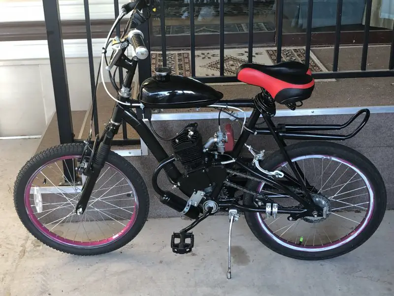

Put the original jet back in. Raise or lower the needle. If you run out of mixture control either richer or leaner then change jets. Likely you are running rich and 4 stroking. Gearing will probably do lots more for speed than doing jetting. Even this little guy makes 32mph any day.
