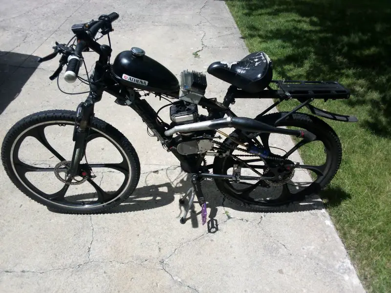

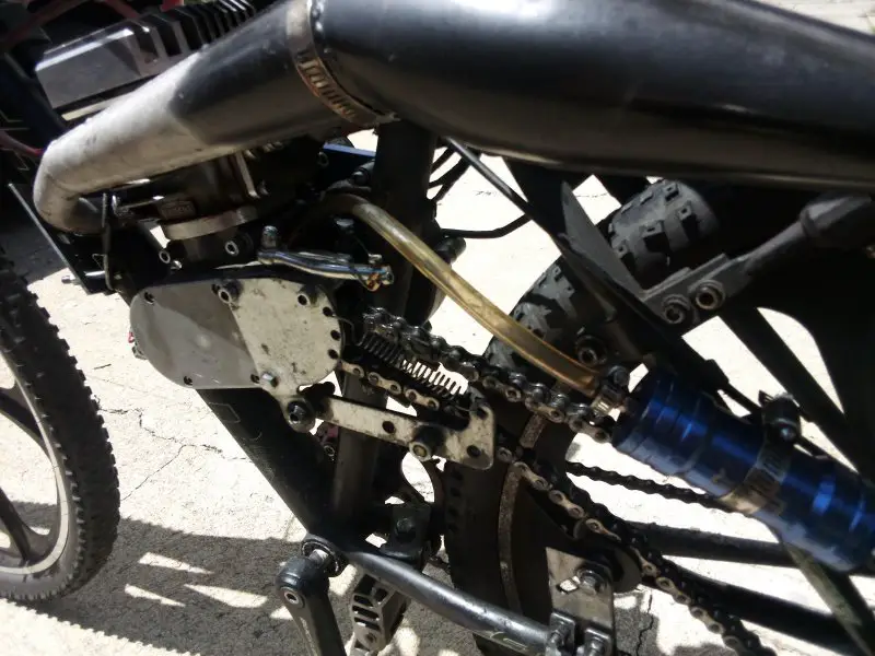

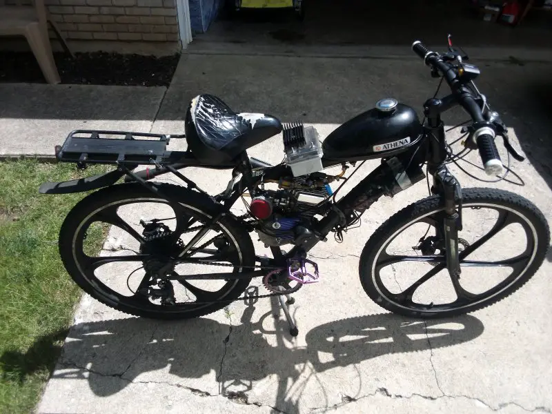

seeee

Indeed! Nice bike btw.
I am running a yd100 lower ported and polished for the Ld100 cylinder 50mm piston with a billet hp head, hp carb with a 78 jet, timing retarded @ 4 degrees with the f2 pipe and a 32 tooth back gear on a hub mount
. I have the cdi and stand alone sparkplug coil, and ngk plug.
It runs better than anything I have had before it. It will probably do 50 if I pushed it.

to get my f2 exhost on the minarellie i bought a vm80 steel intake and a local muffler shop w chopped the f2 and welded it for like 25$

And I cut /re angled and welded my f2 so it's down and away from spewing oil on my back wheel. It works great!
