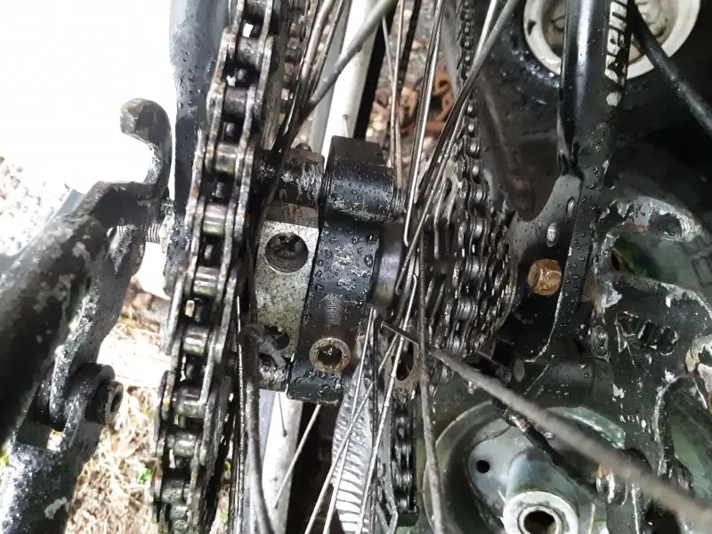

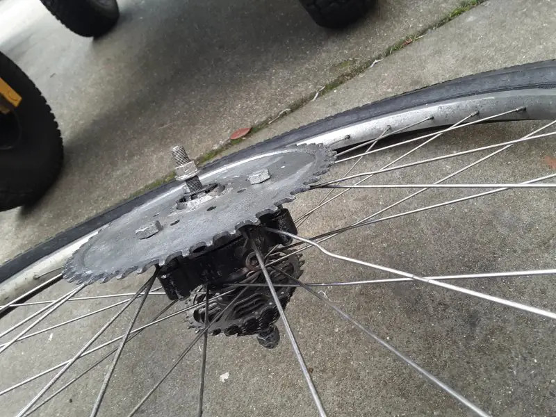

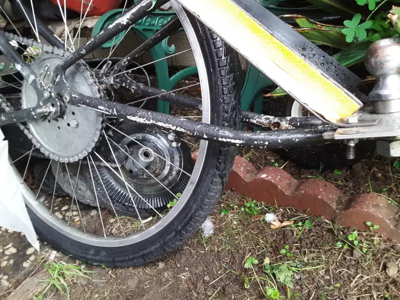

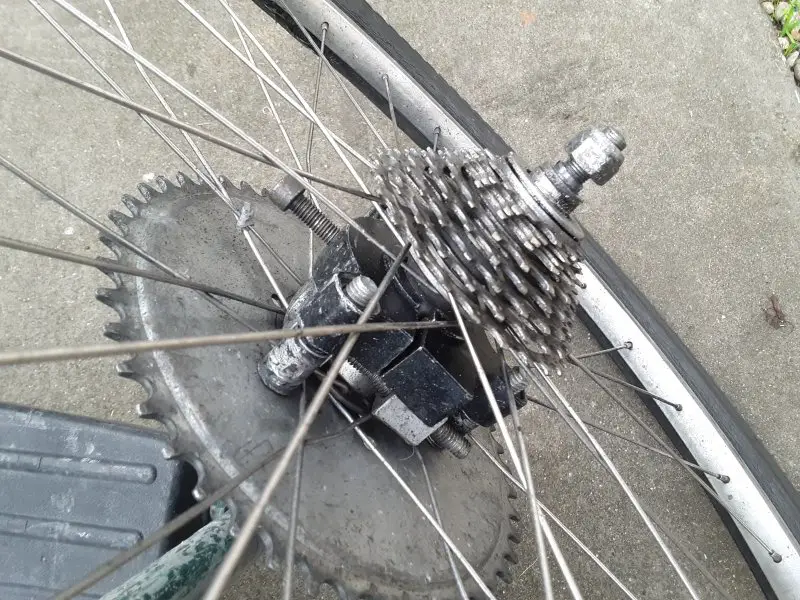

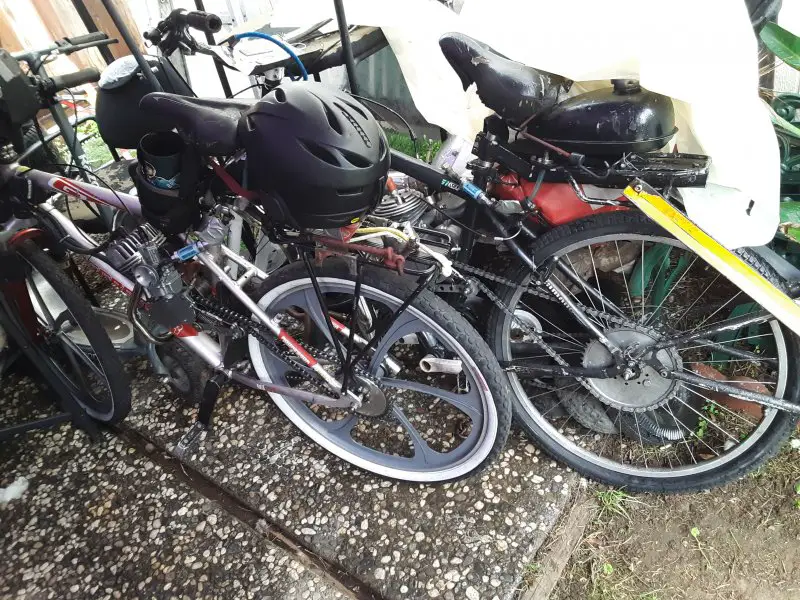

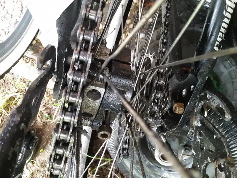

Hi a partner of mine recently went through the same problem with his pedal break back rim long story short them coaster brakes are not designed to handle the load of an engine too much constant torque and the rims are good just for pedaling speed, now a regular freewheel rim will work just fine and the rag joint is garbage I've gotten the hub adaptor and an extra clamp for the hub mount I'll send a pict hopefully this might help , good luck.......... lewdog
Ok check it out pictures finally, I've been lazy with the forum lately please excuse my laziness, so I'll explain in short, the 3b bolt clamp to the hub plus I've drilled n tapped extra hole for more in the bracket to put a bolt through to bite in to the hub actual and then the extra bracket to keep the black one from sliding forward or at all also I've changed the bolts to real bolts and not machine bolts with hex head, so far that rim ive broken 3 spokes I have to change the rim today but later ive got to take it to work this morning it's wobbly but it still rolls kinda dangerous but what's life with out risk and both bikes run the GT Aggressor is fun fun fun not super fast but I'm keeping up with traffic in the city streets ,(scary drivers out there) and the black bike is the work truck some 29in mt bike aluminium fraim cheap parts all over it but it works and falling apart, I gotta do what I gotta do right f.it all in all I love my bikes especially the new one check this out my girlfriend got me a gas tank bike from cdh power fully functionally working bike but no pictures yet I'll get to that in another forum heading named,gas tank ripperr or something like that ok then good people hope this helps out a little..........lewdog

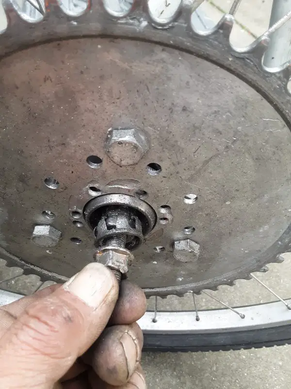

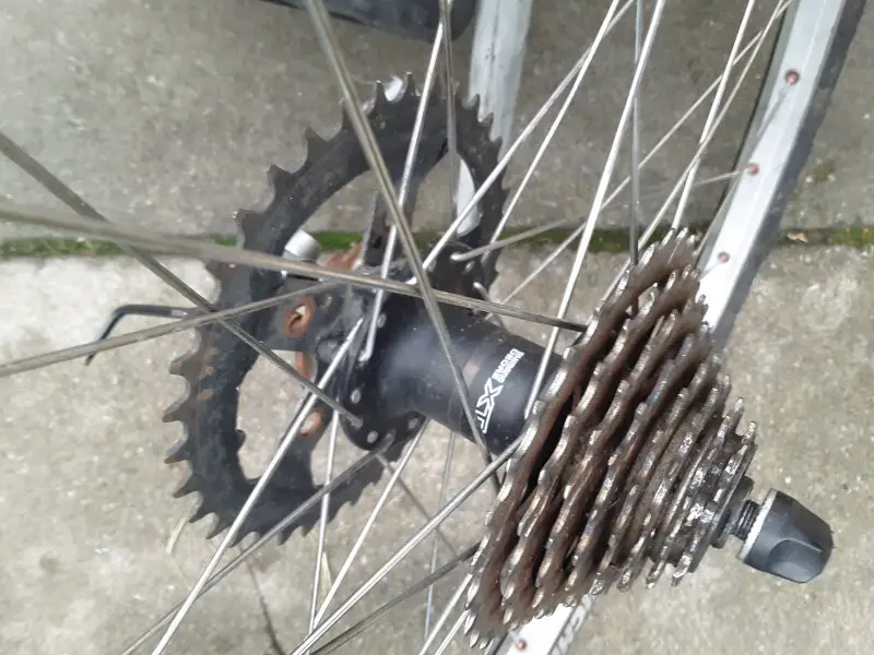

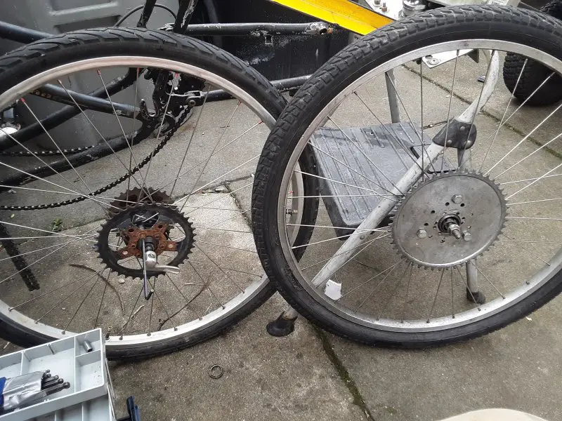

Ok more details the hub fell apart and now swapping rims

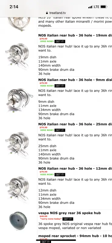

12mm axle is the way to go, I like moped drum hubs with a wide range of sprocket sizes and possibly with a 16 or 17 mag wheel as part of it. You do need to search around and make sure you buy the right hub, brake plate, and sprocket ID.
https://www.treatland.tv/
I had a hub linked but there are no sprockets for it for sale. So I just give you this screenshot.
