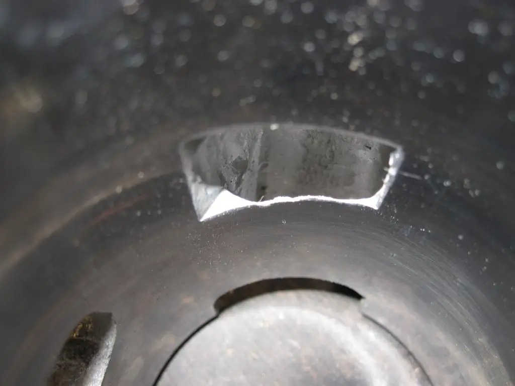

The head's mating surface is damaged, this does not worry me as I planed to modify the head, still it probably would have caused a leak.
But the barrel, will be sent back!
It has pitting in the bore, and porosity bubbles on the mating surface, so if the head didn't cause a leak this would have surely.
The crank has several 'marks' as though its been 'adjusted' with a cold chisel?
And the sharp edge on the step down to the clutch taper would surely damage the seal on assembly.

I have contacted the seller over the barrel, last motor I got from them had a flat spot on the clutch flywheel teeth, and they gave me a $30 refund, so hopping for the same.
I'm going to check my port timing and squish, and see if I can deck the barrel, it may still be usable, if not with a 40mm crank then with a 38mm crank.
