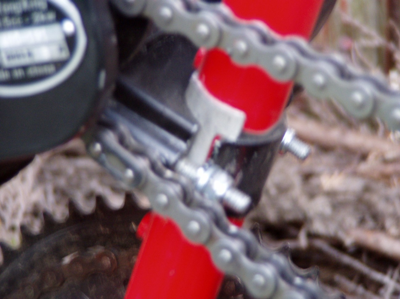

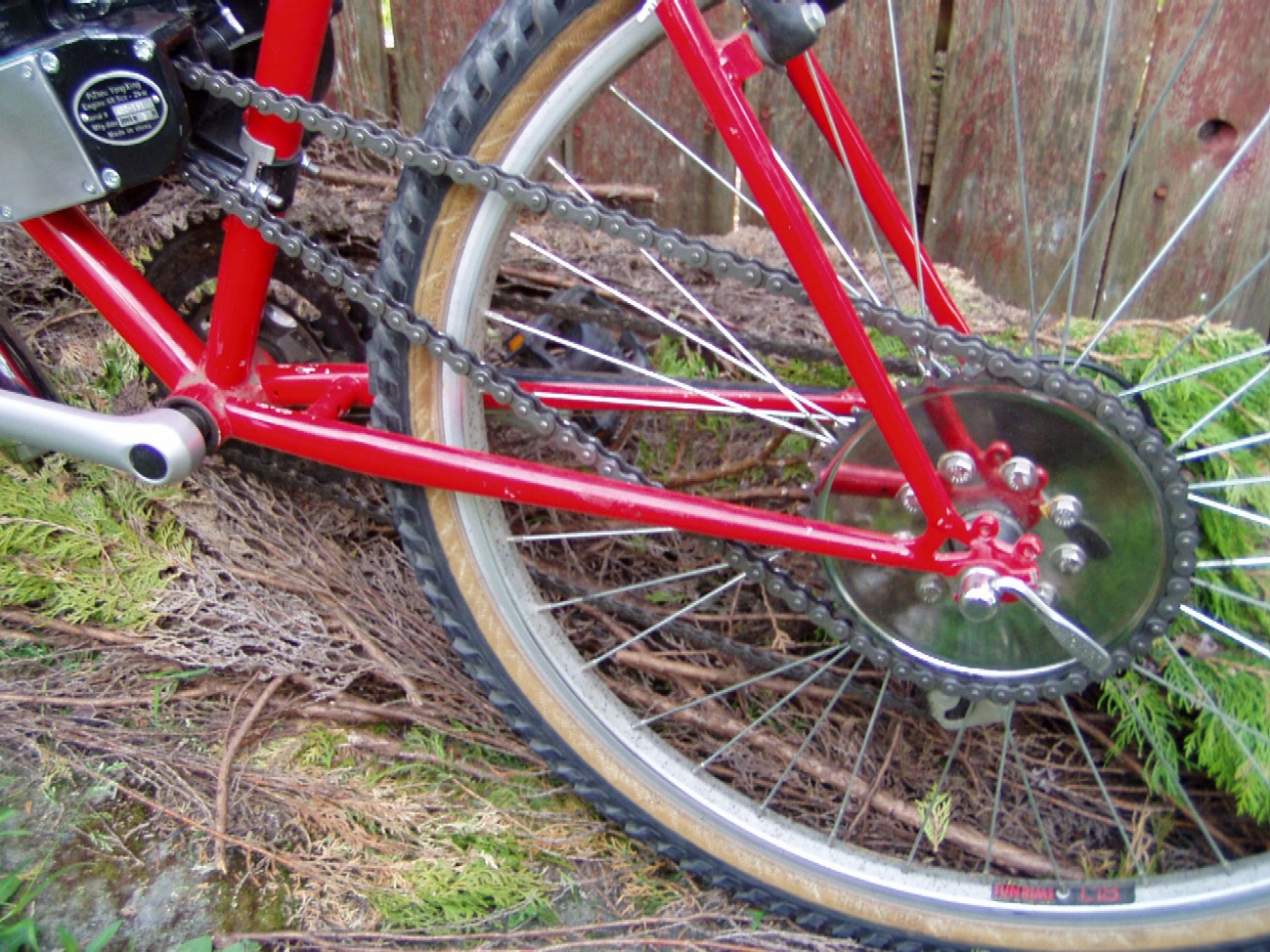

Sry I'll take another one tomarrow. It's just a piece of aluminum sheet about 1/16" thick cut kinda in the shape of a tee shirt layed flat. The arm tabs just hook the motor mount so it stays in place while you tighten it up.
