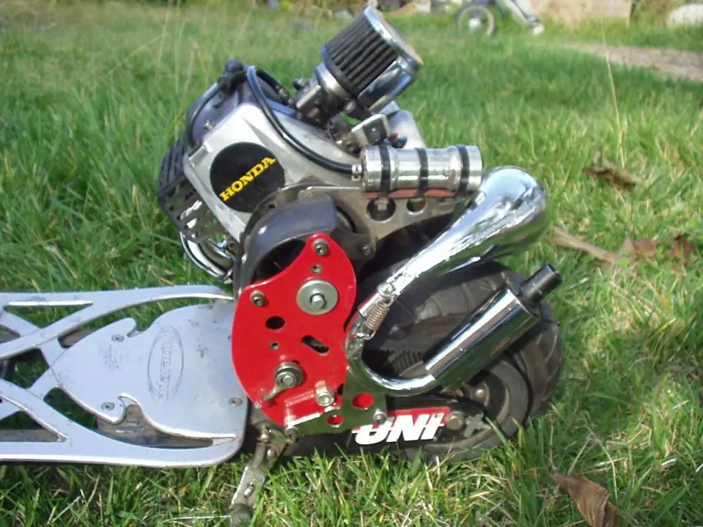

All I have run on the one Tanaka 33cc that I own was the stock can for a brief period when it was new and then I was able to get a brand new "Tanaka" HP 3-piece wrap around tuned expansion chamber.
The 3-piece had a built on silencer that also had an adapter that let you run the stock can (muffler) on the stinger outlet for extra stealthness.......very quiet yet powerful (for 33cc's lol).
The 3-piece were connected by strong springs which made the pipe nearly indestructible from vibration.
If you can find this pipe......I highly recommend it!
I found a few pics of virtually the same pipe (slightly larger 40cc Tanaka) without the can mounted on the end, but you get the idea....
That's the pipe you want....the factory pipe for the 33cc Tanaka! Ya just have to wrestle it to fit your bike :D
