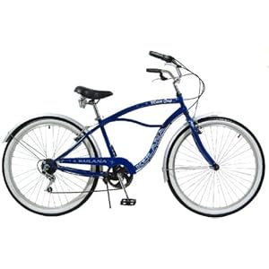

I'm finally going to motorize my green Kulana Moon Dog I've owned since 2005,
thinking of the 4-stroke super titan??? Anyone experienced with this build/bike
combo & mounting procedures? Please share, especially any mount fabs that
MUST be done. Thank you!
Is this the bike?
If yes it doesn't look like there is room for a 4-stroke super titan in the frame.
I could be wrong but if it will it's tight fit.
Some info here
http://www.youtube.com/watch?v=COGUh-UFgO8
http://www.bicycle-engines.com/4-Stroke-Manual.pdf
yes, that's the one except it's green. I spoke with dax, turns out it'll fit with
some mods to the mounting plate and pedal crank bending. That's just a little
bit out of my comfort zone mechanically, installation wise. I've opted for the
hassle free f80 2 stroker, dax say's it'll fit like a dream. (^)
