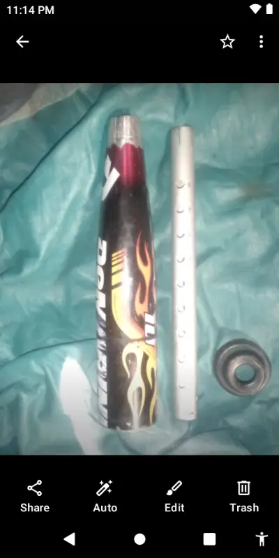

Next take the crutch and remove the adjustable sliding bottom piece that allows you to adjust it for people's height.
Next take and cut the top off of the can that you are going to use for your cap.
And you should end up with these three pieces. See photo.

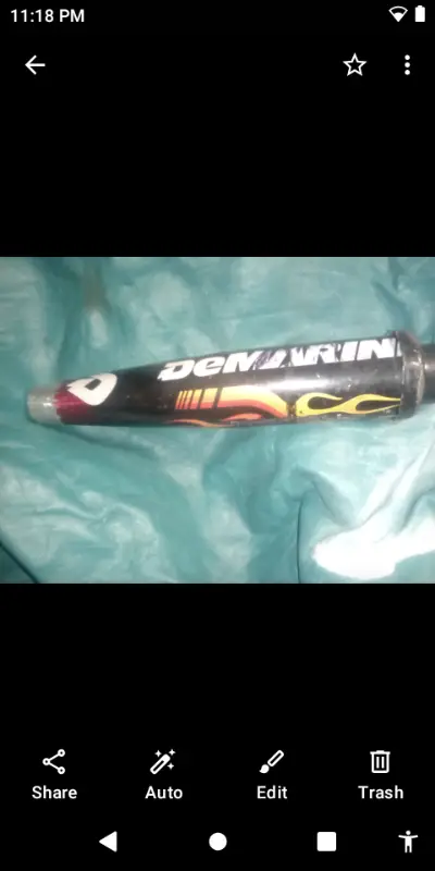

Next take the baseball bat and cut four or five slots in the end so that you can put a hose clamp on it to clamp it onto your pipe. Take and grind a flat area for the hose clamp to sit on. See the second picture.

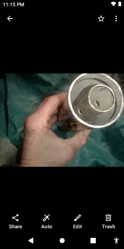

Put the piece of crutch inside of a baseball bat like this. Thrird picture

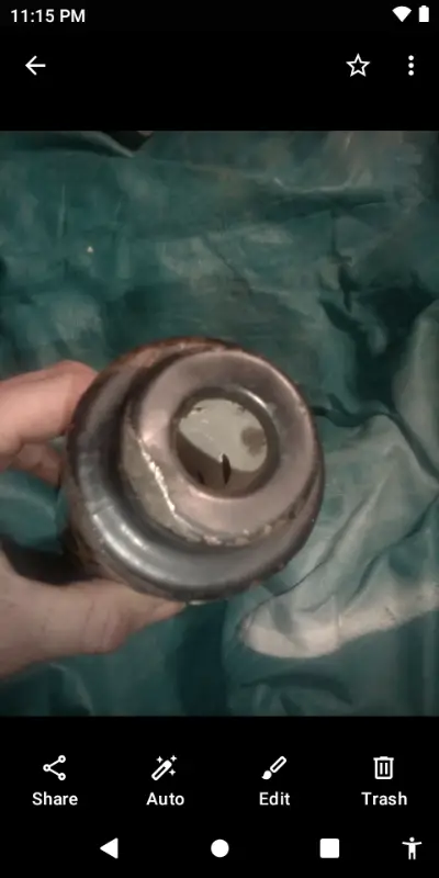

Then take the top of the paint can that you've chosen and put it over the end of the bat drill a couple holes in it so you can pop some rivets in it and you're done.

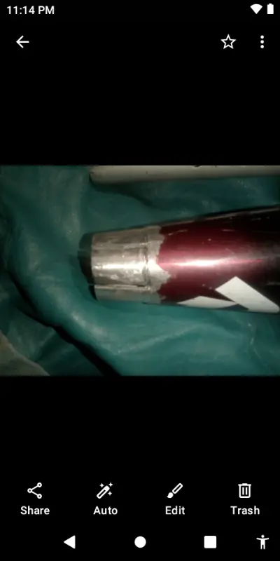

Thank you brother! Once I get it sanded down and detailed I will post a couple more pics. I love to repurpose and MacGyver stuff. Like my pops used to say you're only limited by what your imagination will let you get away with.

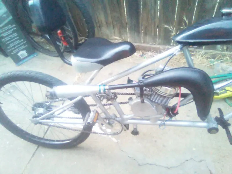

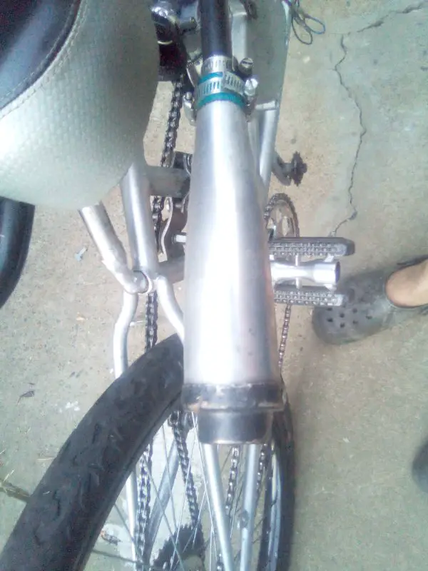

This is what it ended up being... I just wrapped some thin supple leather around it to seal it. That is the turquoise color that you see on the pipe. It's the bomb. I noticed I can slide it back and forth to give me different power bands. The farther twords the end of the stinger the more top end and the shorter I make it the better bottom end.
